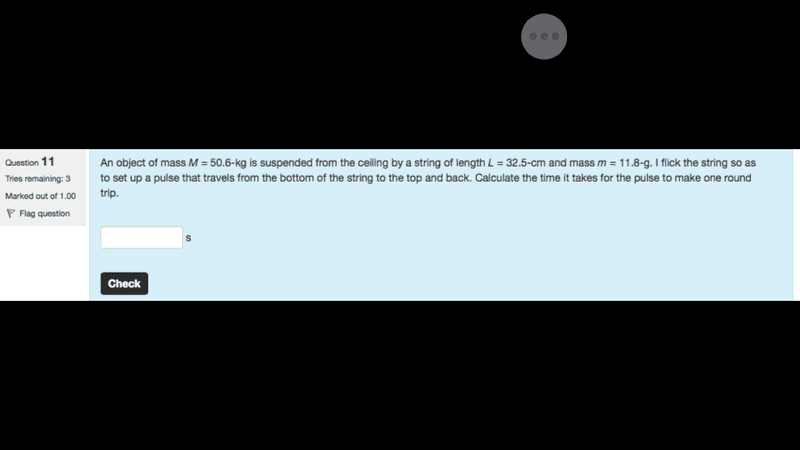

Pendulum pulse vertical flick period
The discussion revolves around the calculation of the period of a pendulum using the formula T= 2pi*sqrt(L/g). The initial calculation of the period was found to be 1.14 seconds, but this was deemed incorrect. Participants questioned the justification for using the simple pendulum formula, suggesting that the motion of the hanging mass and the specific physics context should be considered. There is an emphasis on providing a complete problem statement and detailed solution attempts in future discussions. Clarity and justification in problem-solving are crucial for accurate physics analysis.
James Ray
T= 2pi*sqrt(L/g)
T= 2pi*sqrt(0.325/9.8)=1.14 s
That seems like a reasonable answer.
[/B]
Incorrect.
What is your justification for using the formula for the period of a simple pendulum? Is the motion of the hanging mass relevant here? What type of physics is being asked about?
In future, please type out your problem statement and solution attempts. Justify your approach and steps.
