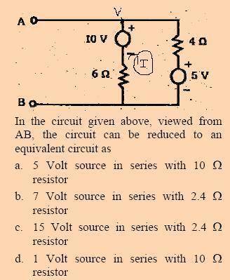

Hello friends...in this questions the answer is (b) option...this is from indian engg. services exam.
if we apply mesh in loop which i have shown , then we find that
I = (10 - 5 )/10 = 0.5 amp
V=10 - 6 I = 7 volt (right acc. to answer keys)
and Rth = 2.4 ohm (i have calculated Rth)
but if we apply Nodal analysis where V is marked then
acc to that
(V-10)/6=(V-5)/4
V= -5
so we see that both results are not equal...but in answer keys 7 volt is given...
please tell me what is the problem in second method of nodal analysis.? is this wrong ?
thanks in advance...

V= 10 - (volts across 6 ohms) because these have opposite polarities.
so (volts across 6 ohms) = 10 - V
Current in 6 ohms = (10 - V) / 6
Then it works out.
40 - 4 V = 6V - 30
10 V = 70
V = 7
acc to that
(V-10)/6=(V-5)/4
V= -5
You are applying nodal analysis, calculating the current in each branch from the node where V is located. The sum of these currents (leaving the node) must total zero. What you've written equates the currents in each branch -- this is not quite right -- these currents will be equal and opposite if the sum of currents is to be zero.
So write instead,
(V-10)/6 + (V - 5)/4 = 0
and see how things go...
In this diagram,
[PLAIN]http://dl.dropbox.com/u/4222062/loop.PNG
If you look at the polarity of the left branch, then V = 10 - ( voltage across the 6 ohm resistor).
Since the currents in each resistor must be the same it is valid to work out these currents in terms of V and then solve for V.
In the right branch, current is flowing downwards so the polarities add up the screen and these must also equal V.
thanks a lot sir...i understood mistake done by me...
