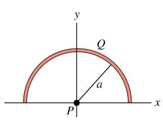

Positive charge "Q" is distributed uniformly around a semicircle
8 replies · 6K views · last reply
squelch
56
Positive charge Q is distributed uniformly around a semicircle of radius a. Detirmine ##\vec{E}## around at the center of curvature P.

So, I had redone the procedure because my answer didn't match other expected answer. Please let me know if this corrected procedure makes sense:
The ##\vec{E}## due to an infintesmal portion of the semicircle, ##dl=ad\theta## with charge ##dQ## is:
##d\vec{E}=K\frac{dQ}{a^2}\hat{a}## where ##dQ=\lambda dl=\lambda ad\theta##
Its components are, therefore,
In X:
$$d\vec{E}_x = d\vec{E}cos\theta d\theta = K\frac{dQ}{i^2}$$
$$\because dQ=\lambda ad\theta$$
$$d\vec{E}_x = \frac{K\lambda}{a}cos\theta d\theta$$
Integrating, we find that:
[tex]{\vec E_x} = \frac{{K\lambda }}{a}\int_0^\pi {\cos \theta d\theta } = \frac{{K\lambda }}{a}[\sin \theta ]_0^\pi = 0\hat{i}[/tex]
In Y:
[tex]d{\vec E_y} = \frac{{K\lambda }}{a}\sin \theta d\theta[/tex]
[tex]{\vec E_y} = \frac{{K\lambda }}{a}\int_0^\pi {\sin \theta d\theta } = \frac{{K\lambda }}{a}[ - \cos \theta ]_0^\pi = \frac{{K\lambda }}{a}[ - 1 - 1] = \frac{{ - 2K\lambda }}{a}[/tex]
##\because \lambda=\frac{Q}{\pi a}##
$$\vec{E}_y=\frac{-2KQ}{\pi a^2}$$
$$\therefore \vec{E}_{total}=\vec{E}_x\hat{i} + \vec{E}_y\hat{j} = \frac{-2KQ}{\pi a^2}\hat{j}$$
It might be correct, but how are the coordinate axes related to the axis of the semicircle?
ehild
The image matches this diagram:
Diagram of a semicircular arc of radius a centered at point P on the x-axis, labelled Q on the arc, with the x and y axes drawn and a radius line from P to the arc.
It is correct. Nice work and nice figure!
