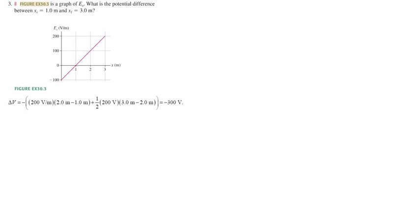

I posted the question and the answer from the book inside the paint document.
My question is why is the answer not...
Δx = 3-1 = 2m
ΔE = 200-0 = 200V/m
ΔV = -(Area under E vs x graph) = -Δx*ΔE/2 = -200 V
Δx = 3-1 = 2m
ΔE = 200-0 = 200V/m
Your answer looks right to me.
What the book has for a solution is bizarre .
The vertical axis isn't Volts it's V/m (eg the rate of change of V with distance).
