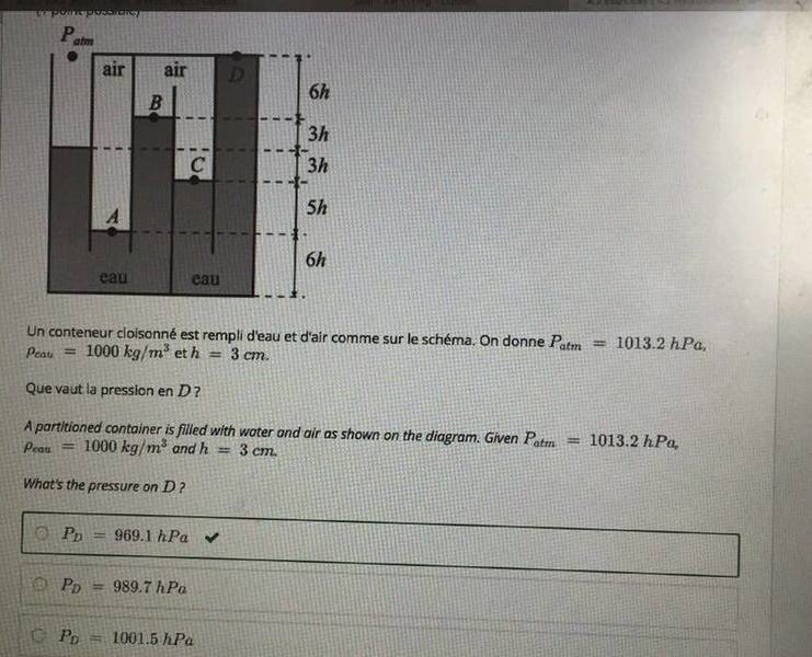

Pressure due to uneven water distribution in connecting pipe
The discussion focuses on understanding the pressure differences in a system of connected pipes, specifically between points C and D. The confusion arises from the calculation of pressure at point D, where the expected difference is based on a height of 12h, while the provided answer indicates 15h. Participants clarify that the 15h relates the pressure at D to atmospheric pressure, while the 12h reflects the difference in pressure between points C and D. To resolve the confusion, it is suggested to analyze the pressure at each point in the system sequentially. The conversation emphasizes the importance of understanding how atmospheric pressure interacts with the pressures in the system.
rwooduk
757
59

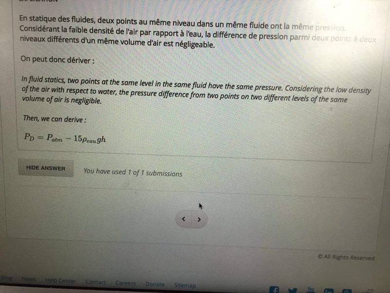

Im confused by this question, just looking at the diagram without any maths you can see what would happen. C and D would want to reach equilibrium and be at the same level so the pressure down on D would be the difference in heights of the fluid. ie. 12 h times p g. but the equation says 15 not sure how they arrived at that? could anyone here help please? i am trying to get the formula given
The 15h in the answer relates the pressure at D to atmospheric pressure. You are right that the pressure at D is related to the pressure at C by 12h.
Likes rwooduk
Many thanks for the reply! ok so the pressure at D, is the atmospheric pressure minus (because it acts in the opposite direction) the pressure due to unequilibrium? I still can't see where the 15 comes from, please could you expand a little? thanks again
See if you can work your way through the system point by point. Find P at A, then B, then C, then D. (You can probably skip A.)
Likes rwooduk
ok will try that, thanks again!
