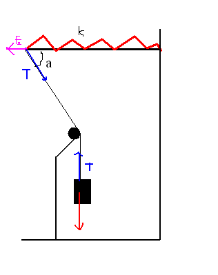

Well, we are given the following system, in which the rope, spring, and pulley is ideal. We know that for the angle [itex]a[/itex] the system is in equilibrium. The question is, to show that if the angle a is small, the system does unfirom oscilations.
Diagram of a pulley system: a spring with a horizontal force F on its left end is attached at an angle a to a rope that runs over a pulley to a hanging block, with tension T labeled on the rope and on the block, and weight shown downward.
I don't know how to tackle this problem, it confuses me a little. We must show that the resultant force on the body is proportional to a constant and the displacement for the equilibrium position at a given time.
Some basic trigonometry, with some tricks for aproximating the trigonometric function for small angles and basic vector addition, I think...
Well, the first thing that is obvious is that if the system is at rest, then:
[itex]T\cos{a} = ky_0[/itex] , where y_0 is the initial comprimation of the spring, and k is its spring constant.
Writing the resultant force for the body we get that: [itex]R = T - mg[/itex]. How do I continue from here? Can somebody help me, please :D ?

You mean ".. if the deviations from angle a are small ...", right?
So consider a small deviation in a. Find how that affects the forces and accelerations, and thus how the deviation will change over time.

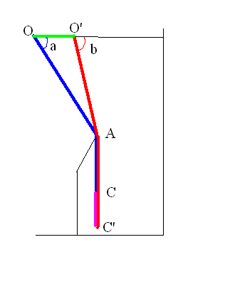

Well, the forces that act on the body are the tension and the weight. The tention depends on the amount of comprimation of the resort. I drew a picture. The resort compresses with OO'(green) and the body descends with CC'. I should find a relation between the two length. I drew the system in a more "gemoetrcal" way because we are interested in lengths, and relations between plain figures, right ?
Geometric diagram of a spring-pendulum setup: a horizontal green segment OO' at the top, a blue rod from O to point A, a red spring from O' to A, and a vertical blue and magenta line from A down to C and C'.
Let us say that OO' = x because it seems a more familiar notation, and we are interested specifically in that length. When the system is in the state corespoding to the 'b' angle, the spring is compressed with: [itex]y_0 + x[/itex] and we know the expression for y_0. So if the compression of the spring affects the tension, it affects the motion of the body, because tension acts on it. :D
Is my drawing and my judgement correct:D ? Tell me, please. If yes, how do we proceed? I haven't found a connection between CC' and OO'. :(

OO' and AO' are related via the triangle OAO', where OA and angle O are constant. AO' + AC' = constant length of the rope.

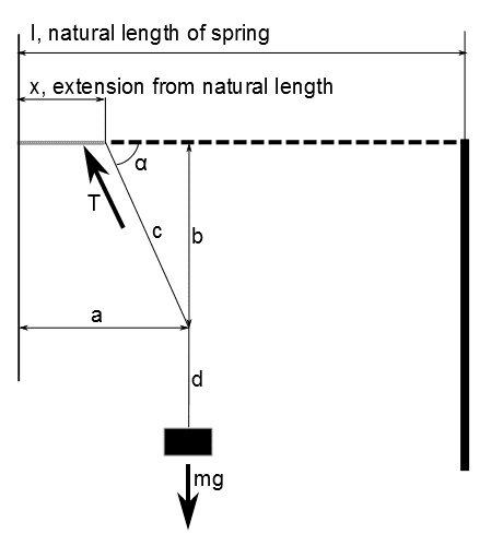

This drawing might be helpful.

Thank you! Now It begins to make sense. Can you tell me what program did you used for drawing this on a pc? I would like to post better pictures, so that people who answer me can help me much easier.
Well, from now on, I'm going to use the notation on your drawing, because it's very clear and well done.
So, on your drawing , we know that: [itex]c + d = constant[/itex]. But I can't see the displacement of the body. And we need to find a connection between the displacement of the body and the comprimation of the resort, right?
Oh, wait a minute. Your drawing is for a general state. So let's consider the length a,b,c,d,x for state 1 and a', b',c',d' for state 2. Also let's consider alpha and alpha'
We have that: [itex]c + d = c' + d' \to d' - d = y = c - c'[/itex]
We can easily see that: [itex]c = \frac{a -x }{cos{\alpha}}[/itex] and [itex]c' = \frac{a - x' }{cos{\alpha'}}[/itex]
So, combining the two equations: [itex]y =\frac{a - x}{cos{\alpha}} - \frac{a - x' }{cos{\alpha'}}[/itex]

But I have a question to ask. Why did you use ## (a - x) = c \cos \alpha ## and not ## b = c \sin \alpha ##? The latter seems a better choice, because it includes only one variable, the angle.
True, but another equation is needed linking x to alpha, since x is related to the force from the spring. tan(α) looks relevant.

Let's just put together a sufficient set of equations before we worry about which variables to eliminate. Writing
s = relaxed length of spring
x = compression of spring
k = spring constant
α = angle
y = length of hypotenuse
b = vertical distance from pulley to spring
T = tension
m = mass
there are fairly simple equations relating:
1. b, s, x, α
2. T, α, k, x
3. y, b, α
4. T, m, g, ##\ddot y##
Four variables, four equations, which in principle can boil down to one variable, one equation. But actually doing that will produce quite a mess, so instead consider perturbations from the equilibrium: ΔT = T - T0, etc. Note that ##\ddot y = \ddot{\Delta y}##.
Even then, you don't need to be too exact. You only need to show that ##\ddot{\Delta y}## ~ ##c \Delta y## for some negative c.
