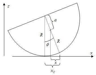

The hemisphere is of radius R.
Prove that the period equals that of a mathematical pendulum of length [itex]4R/3[/itex]
I have a solution, but i don't understand.
Center of gravity:
[tex]a=\frac{3}{8}R[/tex]
Moment of inertia round the center of mass:
[tex]I_C=\frac{83}{320}mR^2[/tex]
Kinetic energy consists of: T1, linear velocity of center of mass and energy of rotation round center of mass, T2:
[tex]T_1=\frac{1}{2}m \left(\dot{x}^2+\dot{z}^2\right)[/tex]
[tex]T_2=\frac{1}{2}I_C \dot{\phi}^2[/tex]
Potential energy: V=mgz
There is no sliding, so, the x coordinate of the center of mass is:
[tex]x_C=\phi R[/tex]
The connection between [itex]\phi[/itex] and x and z:
[tex]x=R \left(\phi -\frac{3}{8}\sin \phi \right)[/tex]
[tex]z=R \left(1-\frac{3}{8}\cos\phi \right)[/tex]
Small angles approximation:
[tex]x=R \frac{3}{8} \phi R[/tex]
[tex]z=R \left( \frac{5}{8} + \frac{3}{16} \phi^2 \right)[/tex]
Now i start not to understand.
It is written that:
[tex]V=\frac{1}{2} \frac{3}{8} mgR \phi^2[/tex]
It has the units of energy, but which?
And:
[tex]T_1=\frac{1}{2} \frac{25}{64} mR^2 \dot{\phi}^2[/tex]
If i compute the members of the kinetic energy, it is only the first member in it.
And the period is:
[tex]\omega^2=\frac{\frac{3}{8} mgR}{\left( \frac{25}{64} + \frac{83}{320} \right) mR^2}[/tex]
The denominator is the moment of inertia round the contact point with the floor.
It resembles the equation for kinetic energy:
[tex]E=\frac{1}{2} I \omega^2[/tex]
But in our solution ω isn't the angular velocity, but the period.

The expression for ##x## is not correct. You have two factors of R (probably just a typo), but in addition it doesn't appear that you made the small angle approximation correctly for ##x##. The expression for ##z## looks ok.
It is written that:
Remember that you can always add or drop a constant when defining the potential energy
Did you include the ##\dot{z}## contribution to ##T_1##?

There is a mistake in the header of x. the equation x=R[itex]\phi[/itex] is for the center of the hemisphere, maybe that was your intention.
Sorry. "typo" is an abbreviation for "typographical error". You wrote ##x = R\frac{3}{8} \phi R##. The left hand side of the equation has dimensions of length while the right hand side has dimensions of length squared. So, that can't be correct. Also, the 3/8 factor is incorrect. Can you show the details of how you made the small angle approximation for x?
Right, a small mistake, the approximation is:
[tex]x=\frac{3}{8}R \phi[/tex]

I think it's possible to argue that the contribution of the ##\dot{z}^2## term to the kinetic energy is negligible for small oscillations.
And the period is:
That's not the period, it's the square of the angular frequency. But there is a simple relationship between ##\omega## and the period.

No, the 3/8 factor is incorrect. Can you show how you got it?
Right, the approximation should be:
[tex]x=\frac{5}{8}R\phi[/tex]

How did you arrive at this equation in the first place? Its meaning should be clear from its derivation.
I didn't arrive to it, i received it as part of the solution.
So, is ω the frequency, in this equation? and you say it isn't:
So, what is it, then? it has exactly the same form
For small oscillations of the hemisphere, the angle of displacement from equilibrium, ##\phi##, will vary with time as ##\phi(t) = \phi_{max}\; cos(\omega t)## if you choose t = 0 at maximum displacement. Here ##\phi_{max}## is the amplitude of the oscillations and ##\omega## is a constant called the angular frequency. ##\omega## is related to the period as I gave before.
The energy of the rocking hemisphere is the sum of the kinetic and potential energies:
##E = \frac{1}{2} I \dot{\phi}^2 + \frac{1}{2}B\phi^2##
where ##I## is the moment of inertia about the equilibrium point of contact and ##B## is a constant that you can find in your original post.
Since E is a constant, you may evaluate it at the instant the hemisphere is passing through the equilibrium position ##\phi = 0##. Then ##\dot{\phi}## will have its maximum value which you can show is ##\dot{\phi}_{max} = \omega \phi_{max}##. Then you find
##E = \frac{1}{2} I \omega^2 \phi_{max}^2##
The potential energy when [itex]\phi=\phi_{max}[/itex] is:
[tex]mgz_{max}=mgR\left(1-\frac{3}{8}\cos \phi_{max}\right)=mgR \left(\frac{5}{8}+\frac{\phi_{max}^2}{2}\right)[/tex]
Equating the energies at this point and at the lowest point:
[tex]mgz_{max}=\frac{1}{2} I \omega^2 \phi_{max}^2[/tex]
[tex]\Rightarrow mgR \left( \frac{5}{8} + \frac{\phi_{max}^2}{2} \right)=\frac{1}{2} \left( \frac{13}{20} mR^2 \cdot \omega^2 \cdot \phi_{max}^2 \right)[/tex]
And the [itex]\phi_{max}[/itex] on the two sides don't reduce.

Looks like you dropped the 3/8 factor in the term.
You should include the potential energy at the lowest point on the right side.
[tex]mgR \left(\frac{5}{8}+\frac{3\phi_{max}^2}{16}\right)=\frac{13}{40} mR^2 \cdot \omega^2 \cdot \phi_{max}^2 + mg\frac{5}{8}R[/tex]
Still don't reduce
Now you can solve for ω2. What do you get?

I get:
[tex]\omega^2=\frac{15g}{26R}[/tex]
I should get:
[tex]\omega^2=\frac{3g}{4R}[/tex]

To prove it, you can derive the differential equation for ##\phi(t)## and show that the solution is simple harmonic motion. To get the differential equation you can write out the expression for the total energy E as a function of ##\phi## and ##\dot{\phi}## and then take the time derivative of the expression keeping in mind that E is a constant.
I get:
I should get:
But i will check calculations again
I think your answer is the correct one. I don't think the expression in the statement of the problem is correct. Hope I haven't overlooked anything, but I got what you got. I will go back over it.

Another approach is to start with the equation E = KE + PE written in terms of ##\phi## and ##\dot{\phi}## and separate variables so that ##\phi## and ##d\phi## occur on one side of the equation and ##dt## on the other. Then integrate both sides to determine ##\phi## as a function of time.
[tex]E_{tot}=mgR \left( \frac{5}{8}+\frac{3\phi^2}{16}\right)+\frac{13}{40}mR^2\left(\frac{d\phi}{dt}\right)^2[/tex]
And i can't seem to separate the dt to the left and ##\phi## and ##d\phi## to the right.
Maybe, in this case, this method doesn't work
You an write this as ##A = B\phi^2+C\dot{\phi}^2## where you can figure out expressions for A, B, and C.
Solve for ##\dot{\phi} = f(\phi)## where you'll see what you get for the function ##f(\phi)##
Separate variables ##d\phi/f(\phi) = dt##
Integrate both sides and consult an integral table if you need to for the left hand side.
[tex]A = B\phi^2+C\dot{\phi}^2 \Rightarrow \sqrt{\frac{A-B\phi^2}{C}}=\dot{\phi}[/tex]
[tex]\int dt=\int \frac{d\phi}{\sqrt{\frac{A-B\phi^2}{C}}}[/tex]
[tex]\Rightarrow \sqrt{\frac{C}{B}} \arcsin \left( \phi \sqrt{\frac{B}{A}}\right)=t[/tex]
[tex]\Rightarrow \phi=\sqrt{\frac{A}{B}}\sin\left(\sqrt{\frac{B}{C}t}\right)[/tex]
And it has the form of harmonic motion.

Good. So, what do you get for ##\omega## in terms of the original parameters of g and R?
Each \; just adds a little space
[tex]\phi(t) = \phi_{max}\; cos(\omega t) \Rightarrow \dot{\phi}=-\omega \phi_{max} \; \sin(\omega t)[/tex]
The lowest point is at a quarter of the period, at:
[tex]t=\frac{T}{4}=\frac{\pi}{2\omega} \Rightarrow \dot{\phi}=-\omega \phi_{max}[/tex]
Yes, that will give ##\dot{\phi}## when the system first passes through the equilibrium position.
If you just want the period, then use the fact that when ##t = T## the cosine function must have completed one cycle. So, the argument of the cosine function will be ##2\pi##. Hence, ##\omega \: T = 2\pi##.
