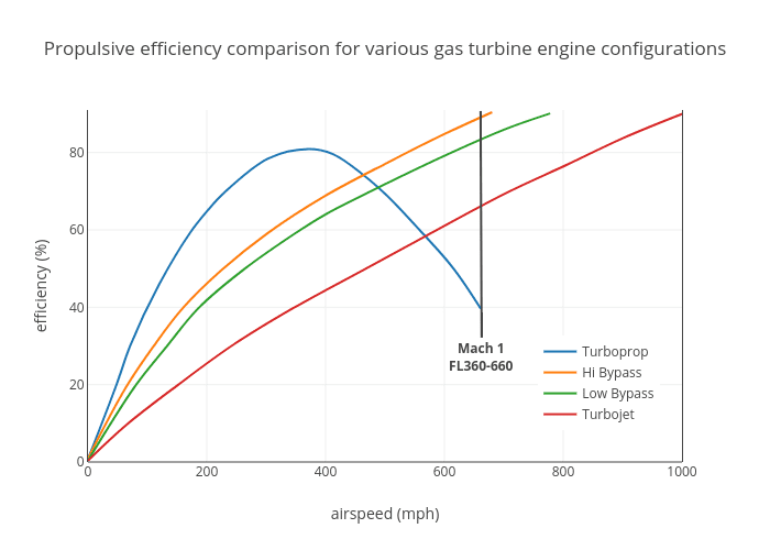

  • Some participants note that current electric aircraft propulsion relies on high energy density Li-Ion batteries, which face limitations compared to fossil fuels in terms of energy density.
  • Concerns are raised about the efficiency of propellers at supersonic speeds, suggesting that jet engines may be more suitable for such speeds due to their reliance on gas heating and expansion.

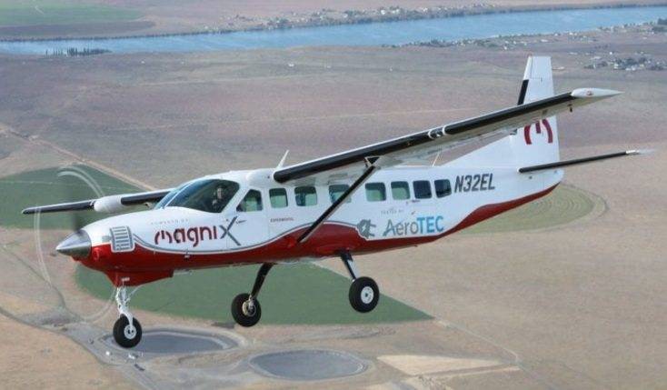

merriam said:
I stand corrected. At the Paris Airshow (june 2019) an electric aircraft was offered for sale. 3 engines, propeller driven, 650 miles at 500 miles/hour. 9 passengers. $4 million each. Roughly a dozen orders.
Don't stand corrected until it happens. I flat-out don't believe those specs are possible.
Edit: searching finds some badly written articles giving the impression it could fly 500 mph, but the actual spec calls for 240kt. Still won't believe it until I see it, but it at least it passes the laugh test at that speed claim.
https://en.m.wikipedia.org/wiki/Eviation_Alice

The key to getting a flyable aircraft is the power/weight ratio of the engine. For Jets, the power outlet depends a lot on the speed, but roughly speaking a Boeing 777 engine (GE 90) puts out about 6 hp/lb (10 Kw/Kg). Very good electric motors can manage power/weight in this neighborhood. Viability depends on having light batteries that hold a lot of energy.
You're forgetting energy storage. Hydrocarbon fuels are currently more efficient than batteries for storing maximum energy in a small volume and weight.
  • #64
Energy storage affects range. Jet fuel has an energy density of about 43 MJ/kg. A fully charged lithium battery can manage about 1MJ/Kg on a good day (maybe half that on an average day). There is a big difference. That means that if your aircraft allocates 1000 Kg for "fuel", you can go farther if you use jet fuel. The electric aircraft referenced above has a range of 650 miles (compare to 777 range of 5000 to 8500 miles) limited strictly by battery capacity (and rules about amount of reserve that must be carried).
But to get off the ground you have to overcome drag (and inertia) and that takes engine thrust. Power is thrust times speed. A typical aircraft has lift = 10 x drag (gliders more, fighter planes less) and the lift has to at least equal the weight of the engine. That's why thrust/weight is so important. Even if the plane is made of super material that weighs nothing, the engines still have to get off the ground.

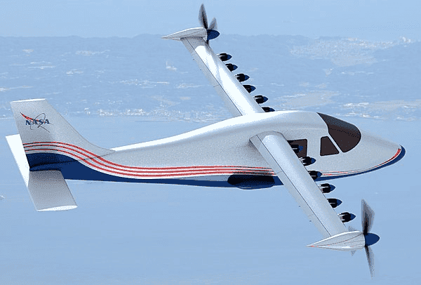

It's worth noting that engine thrust and power are not directly interchangeable concepts. Modern jetliners have vastly more power than they need to get off the ground safely, and the reason for this is the need to fly at a high cruise speed. If you eliminate the high cruising speed requirement, you can change over to propellers with a significantly larger disk area than the exit area of the jet engines, and by doing so, you substantially improve the power to thrust ratio.
This is also why all the electric concepts have multiple motors driving fairly large props along with a relatively low cruising speed - all of those things reduce the total power requirement.

Pretty much all modern turbofans run with a blade tip speed at full throttle of mach 1.5 or so.
4MW isn't anywhere close to enough. Propulsive power at cruise for a modern jetliner the size of a 787 is more on the order of 40MW. At takeoff, each engine has to be making more like 50-60MW of shaft power just to run the front fan. Rerun the electric numbers knowing that and you'll see why running jetliners on electric power is a pipedream without a massive breakthrough in technology.
I think you need about 10 tons of thrust per engine during cruise for a 737. If the thrust to power ratio of an electric fan is 6 kg/kW, then you need 10,000 / 6 = 1,660 kW or 1.7 MW per engine. This assumes 95% motor efficiency and 90% propulser efficiency. Developers are building 0.75 MW motors. So four of these will do.
  • #90
You actually don't need anywhere close to 40klb of thrust at cruise for a 737 - that's about a factor of 4 or 5 high. In reality, a 737 might have between 7000 and 10,000 pounds of drag (and thus thrust) during cruise, depending on gross weight, which 737 variant it is, etc.
Unfortunately, though, your thrust to power ratio is also way, way too high. At cruise, a 737 engine might be ingesting around 300kg/s of air at 250m/s. To generate 20kN (4500 lb) of thrust (since it has 2 engines), this air will need to be accelerated to 317m/s by the engine. This involves adding about 11MW of power to the air jet, so using your propulsor efficiency value of 90%, we need 12.5MW of shaft power per engine to generate 4500lb of thrust, for a thrust to power ratio of less than 2N/w.
The reason the power level needs to be so high is because of the high speed and the low density of air at altitude, resulting in a fairly low massflow. With a higher massflow (larger prop disk size, lower altitude) and lower airspeed, you probably could get a 737 to fly on only 3 or 4MW, but you'll never get anywhere close to the altitude or airspeed without 20-30MW.
