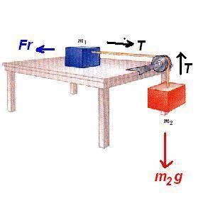

Objects with masses m1 = 12.0 kg and m2 = 4.00 kg are connected by a light string that passes over a frictionless pulley. If, when the system starts from rest, m2 falls 1.00 m in 1.70 s, determine the coefficient of kinetic friction between m1 and the table.

Is there a table in the problem? A drawing would be nice, with free body diagram for both masses.

this is the picture i have
Nice picture:smile:.
Both blocks accelerate with the same amount as they are connected with a spring.
m2 falls 1 m in 1.7 s. What is its acceleration?

Your mistake is in your calculation of normal force. Only m1 should factor into normal force. M2 experiences only gravity and tension :)

The tension in the rope acts upward on m2. See the picture, I added the forces. So the net force on m2 is m2g-T=m2a. What is T then?

Yes, the tension is T=36.432 N.
Now what forces act on m1?
ehild
Tension and friction?
Yes. The tension is the same at both ends of the string. You know acceleration, mass and one force, tension. How much is the other force, the force of friction?

Is ƩFx =0? m1 is accelerating!ehild
M1 = ma
M1 = 12 * .692
M1 = 8.304
M1 = T- Ff
8.304 = 36.432 - Ff
Ff + 8.034 = 36.432
Ff = 28.398
Is this accurate?
Why do you denote force by M?
So the net force on m1 is m1a=8.304 N, and it is equal to T-Ff. But what is 8.034?
ehild
the mass of m1 * acceleration = 8.304
then i take the mass of m1 * gravity = 117.6
u = Ff/Fn = 28.128/117.6 = .239
the answer is.239
Correct !
