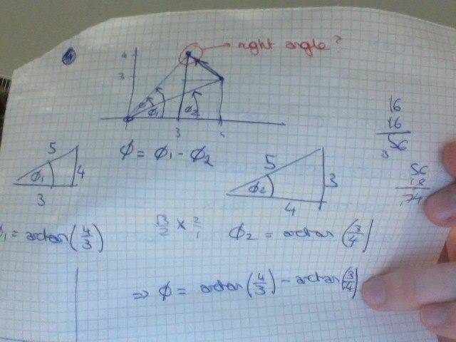

A rotation ρ about the origin in ℝ2 drives the point P = (4,3) to the point ρ(P) = (3,4).
Find the angle of rotation as well as its matrix notation.
Ok so I made a sketch and I realized I needed to find θ = θ1 - θ2 where θ1 and θ2 equal arctan(4/3) and arctan(3/4) respectively.
I guess it's correct but then how would I work out the sin and cos of that angle θ without a calculator?
SO. I worked out the cosine angle between the vectors 0P and 0ρ(P) and got cosθ = 24/2√25
But now I don't know how to work out the sine!

How do you know that this is a right angle though?

tiny-tim said:
hi phyzz! :smile:sec2 = 1 + tan2
cos2 = 1/sec2
sin = cos*tan :wink:
Ohhhhh my bad I didn't see it at first. I just used sin^2 + cos^2 = 1
and the cos of the angle I found between the two vectors.
Thanks!
... in fact, P=(3,4) and Q=(4,3) each make a special kind of triangle.
The rotation angle is the difference between complimentary angles in this triangle - if you recall your special triangles, you don't need the trig.
Of course, since you know the start and finish, you could just expand the matrix equation into a pair of simultanious equations and solve them?
