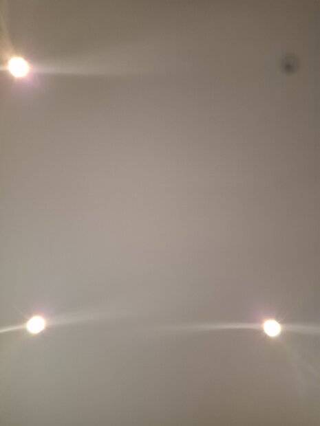

Recessed Lights on ONE Switch
Switch is basic ON/OFF, no dimmer nothing fancy.:
SWITCH goes ON: One light OFF rest of lights ON
SWITCH goes OFF: Light that was OFF now ON rest of lights on but dim.
Hey Everyone
OK This is BOGGLING my mind. How is it even possible? I am trying to figure it out before I look in the Jboxes of the lights.
Any ideas?
Newly installed recessed lights done by skilled electrician.
One switch controls all lights.
SWITCH goes ON: One light off rest of lights ON
SWITCH goes OFF: The light that was off goes ON and the rest go on but are dim.
Also is anyone has a really good wiring diagram for recessed lights, please share!
The lights have individual intelligence and cycle in brightness when momentarily switched off and on again. One light is faulty and does not reset to synchronous operation.
To test, swap a good and a bad. If the problem moves, replace that light.
Apparently, he still managed to mess up the wiring.
He messed up, he should do the cleanup/redo.
Don't touch it.
There should be three in parallel, in series with the singular one, which is shorted by the switch => quite dangerous setup.
I think he managed to connect one of the wires of the singular one to a 'live', non-switched wire...
How did he not check it??
Likes   Reactions: russ_watters, UrbanFarmEngineer, Vanadium 50 and 1 other person
TL;DR Summary: Recessed Lights on ONE Switch
Any ideas?
Yes. My idea is to make the guy who installed them fix it. It's not that difficult to know what happened here on the other end of the internet. If it boggles your mind it is an indication you are in over your head.
Don't touch it.
Yup you got it right. I wanted to challenge myself to figure it out before I opened the can to look inside. I am learning AC Wiring from scratch so I wanted to think it though first.
How did he not figure it out?
The power was completely off to my house so he had no way to turn the switch on. And the way that the wires came into the box it was easy to confuse them when standing on a ladder. I rewired it the exact same wrong way on my first try.
