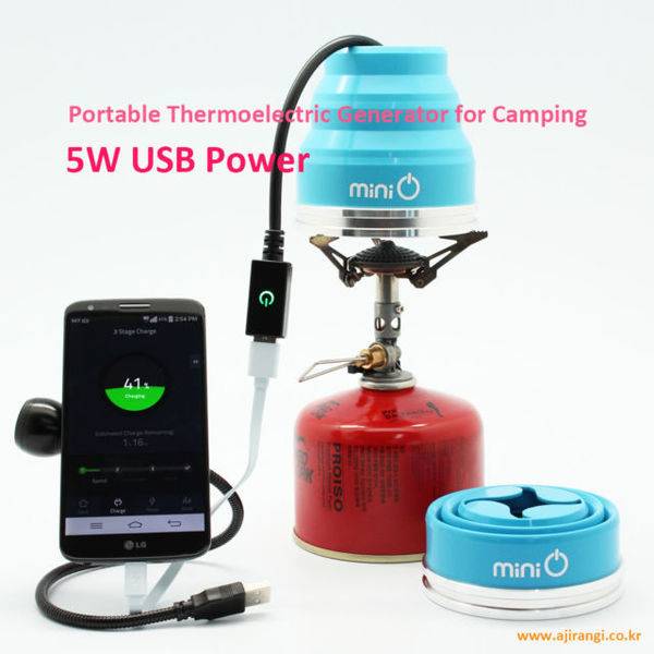

What is the heat source for your Peltier generator? What is the heat flux into the generator? What is the typical efficiency of the conversion to electrical energy? What power do you estimate you have to run the electric motor? Can you show us your calculations so far?
https://www.ebay.com/i/253473259913?chn=ps
