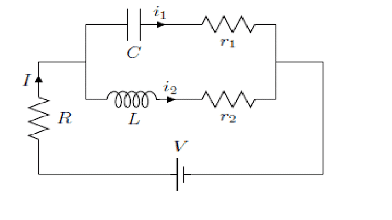

(a) Write down sucient number of equations to determine all the
currents i1, i2 and I (you do not need to solve the equations)
(b) At the instant the battery is turned on, what is the current I
running through the circuit?
(c) After waiting for a suciently long time after the battery is turned
on, what is the current I running through the circuit?
Circuit schematic: a battery V in the bottom branch with resistor R on the left; the top node splits into a branch with capacitor C and resistor r1 (current i1) and a branch with inductor L and resistor r2 (current i2); current I flows through R.
i get 4 equation. You can get them down of the page

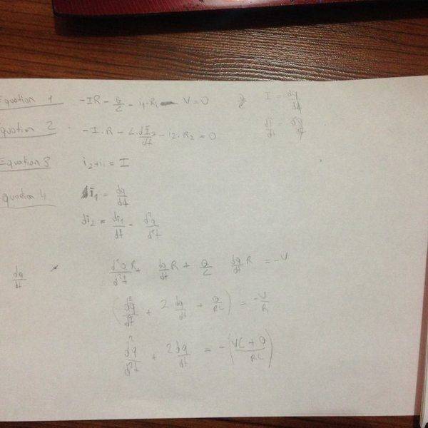

To start, I pick 2 ways and i tried kirchhoff rule and for current i1+i2=I. dq/dt=i1 these are my prediction. İf u have a look my work upload at down, u ll understand my solution attempt.[/B]
Hi Hap, :welcome:
Not a very good start. What does the relevant equation stand for ?
How about checking with your notes or textbook to find what equation describes a capacitor ? Idem inductance ?
Did you check the PF guidelines ? 'Don't know where to start' kind of isn't good enough...
I tried to get quick response but it didnt work so i tried somethings. Here is some works but i can't get question b and c. Maybe i can get little bit help from you guys.
For 2nd equation: there should be mines V.
Handwritten derivation on lined paper of an RLC circuit: Equation 1 is -IR - q/C - i1·R1 + V = 0, Equation 2 is -I·R - L·di2/dt - i2·R2 = 0, Equation 3 is i2 + i1 = I, and Equation 4 gives I = dq/dt, followed by a second-order differential equation in q.
