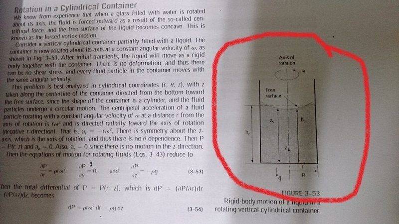

Rotation in a cylindrical cylinder (fluid)

what's the difference between zs and hc ? in the pictuire , they are both drawn from the bottom of water to the free surface ...

hc is the height at the very bottom of the liquid surface, and zs is the height at an arbitrary location on the liquid surface.
