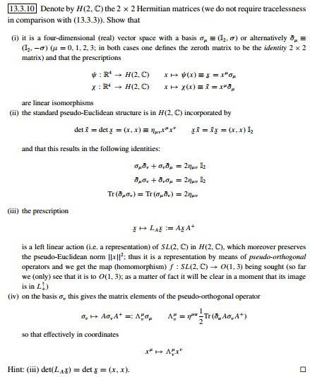

dextercioby said:
Another solid reference on SL(2,C) spinors is the book by Sexl and Urbantke: <Relativity, Groups, Particles>, where the section relevant to this thread is on page 236.
Oh, yes. These authors are funny! They introduce the sigmas tilded, with an upper index. They are identical to those ones with lower index. And there is an explicit warning the reader that this is not the same as using eta to change the index position.

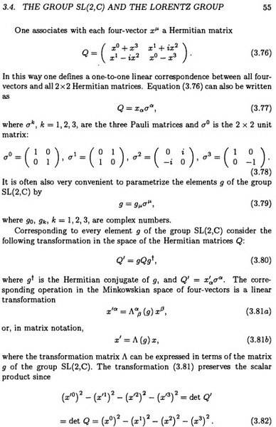

1) I did read the book “Theory of Spinors” 12 years ago and I do not remember seeing any errors in it. However, I do remember that half of the book was about [itex]SL( 2 , C )[/itex] and its representations and the second half was about the spinor formulation of various field theories.
2) You thought that the following equations (from the book) were wrong
[tex]\mbox{Tr} ( \sigma^{ \alpha } \sigma^{ \beta } ) = 2 \eta^{ \alpha \beta } , \ \ \ \mbox{Tr} ( \sigma^{ \alpha } g \sigma^{ \beta } g^{ \dagger }) = 2 \Lambda^{ \alpha \beta } .[/tex]
I have shown you, several times, that the equations are correct and consistent with each other if the trace is an [itex]SL( 2 , C )[/itex] trace.
3) Moshe Carmeli was a very careful writer and teacher. I have read many of his good published paper and three of his books. I believe that he published more that 30 paper and 5 books. He spent his life working on [itex]SO( 1 , 3 )[/itex] and [itex]SL( 2 ,C )[/itex]. In the early 1970’s he formulated his [itex]SL( 2 ,C )[/itex] gauge theory of gravitation and showed that it is equivalent to Einstein’s theory of gravitation. Now days, we speak of the Carameli’s Lagrangian.

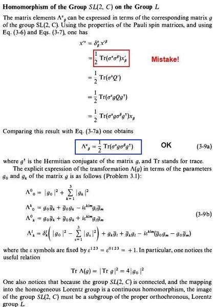

If so how you explain the fact that in "Theory of Spinors" he has
[tex]\Lambda^{\alpha\beta}=\frac{1}{2}\mbox{Tr}(\sigma^{\alpha} g\sigma^\beta g\dagger)[/tex]
While in "Group Theory and relativity" he has
[tex]\Lambda^\alpha_{\phantom{\alpha}\beta}=<br /> \frac{1}{2}\mbox{Tr}(\sigma^{\alpha} g\sigma^\beta g\dagger)[/tex]
Do you notice the difference? I mean, not on the right hand side, right hand sides are the same. But on the left hand side there is a very small and subtle difference. If you see this difference, how are you going to explain it? Just address this simple point. I will really appreciate it. Other readers of these pages will appreciate it as well, I am sure.
Right hand sides are the same, left hand sides are different. Not only different, but if you for a moment suppose thath they are equal, you will easily get 1=0. So they are not just different, they contradict one to another.
Remember: alpha and beta spacetime indices. Sigmas are Pauli matrices. They are exactly the same in those two books.
This equation is correct, if the trace is that of tensor contraction, i.e., when we treat the sigmas as [itex]SL(2,C)[/itex] mixed tensors. In other words, the trace is what I denoted by [itex]\mbox{Tr}_{ sl(2,C) }[/itex].
I have never seen this book. However, by looking at this non-covariant equation, I guess he used the (non-covariant) matrix equality between [itex]\sigma^{ \beta }[/itex] and [itex]\bar{ \sigma }_{ \beta }[/itex] which I warned about in post#41. So, if you plug
[tex]\sigma^{ \beta } = \bar{ \sigma }_{ \beta }[/tex]
back into his equation, you get the correct and covariant equation
[tex]2 \ \Lambda^{ \alpha }{}_{ \beta } = \mbox{Tr}_{M} ( \sigma^{ \alpha } \ g \ \bar{ \sigma }_{ \beta } \ g^{ \dagger } )[/tex]
In this equation, the trace is just that of ordinary matrix multiplication.
On the contrary, the RHS’s are different. The trace in the first equation is [itex]\mbox{Tr}_{sl(2,C)}[/itex] while the trace in the second equation is [itex]\mbox{Tr}_{M}[/itex].

Here is the evidence of the copy and paste job in the two Carmeli's book. Word by word, with just two "little" differences:
Only one of them can be right. Now I know it is Carmeli alone who is right. Carmeli-Malin is wrong. But the proofs are wrong in both. Probably Malin did not notice the mistake in the proof, and wrongly corrected the right formula incorrectly assuming that the proof was correct.
Your remarks are utterly trivial. The equations, you labelled by “Mistake!” and “Not OK!” are indeed correct and OK provided you calculate the trace in [itex]SL( 2 , C )[/itex]. That is
[tex]\mbox{Tr}_{ sl(2,C) } ( \sigma^{ \alpha } \sigma_{ \beta } ) = 2 \ \delta^{ \alpha }_{ \beta } . \ \ \ (1)[/tex]
If you think this equation is wrong, then you should show us, by “rigorous mathematical reasoning”, why it is wrong?
Now, let us follow Carmeli:
[tex] x^{ \prime \alpha } = \delta^{ \alpha }_{ \beta } \ x^{ \prime \beta } = \frac{ 1 }{ 2 } \mbox{Tr}_{ sl(2,C) } ( \sigma^{ \alpha } \sigma_{ \beta } ) \ x^{ \prime \beta } = \frac{ 1 }{ 2 } \mbox{Tr}_{ sl(2,C) } ( \sigma^{ \alpha } \sigma^{ \beta } ) \ x^{ \prime }_{ \beta } .[/tex]
You marked this equation as “Mistake!”. Show us, by “rigorous mathematical reasoning”, where is the mistake?
If we continue with Carmeli’s arguments, we arrive at
[tex] \Lambda^{ \alpha \beta } = \frac{ 1 }{ 2 } \mbox{Tr}_{ sl(2,C) } ( \sigma^{ \alpha } \ g \ \sigma^{ \beta } \ g^{ \dagger } ) .[/tex]
You marked this equation by “Not OK!”. Show me, by “rigorous mathematical reasoning”, why it is not OK?
However, I have an issue with Carmeli’s argument that led to the-silly-looking Eq(3.9a) which you marked as “OK”. He starts the argument using Eq(1) for the [itex]SL( 2 , C )[/itex] trace, then he jumps to conclude Eq(3.9a) which deploys ordinary trace.
In both books the derivation is silly because they have not defined the space under which the trace is taken. They should have (as I have done in the first part of post #41) defined the [itex]\bar{ \sigma }^{ \beta }[/itex] and used the fact that
[tex]\mbox{Tr} ( \sigma^{ \alpha } \bar{ \sigma }^{ \beta } ) = 2 \ \eta^{ \alpha \beta } .[/tex]
