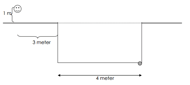

Diagram of a pool cross-section with a smiley-face figure at the left edge, marked 1 m tall, and a grey stone at the bottom right corner; labels show 3 meter horizontal distance from figure to pool edge and 4 meter pool width.

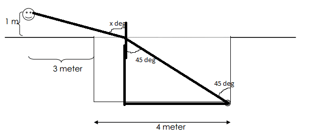

A stone lies to the very edge at the bottom of a pool. The pool is filled with water to the top. The person standing three meters away from the pool is 1 meter tall and he can see exactly the half of the stone. Calculate the depth of the pool.
Snell's law: n * sin(x) = n2 * sin(y)
Diagram of a stick figure at the left edge viewing a stone at the bottom right corner of a pool, with the sight line refracting at the water surface; labels 1 m height, 3 m horizontal distance, 4 m pool width, 45 deg, and x deg.
Okay.. Since I can see half of the stone, the angle should be 45 degrees, right? I should be able to calculate x degrees and therefore the bottom of the triangle (where he stands). With the bottom, I can calculate the bottom line of the triangle in the pool and then the depth. So I do that.
sin(45) * 1.33 = 1.00 * sin(x)
1.33 is n for water. 1 is n for air. x = 70.05 degrees.
So the inside of the triangle is approx 20 degrees. I use tan.
tan 70 = 1/adjacent => 1/(tan 70) = adjacent => 0.36397. So the bottom of that triangle is 0.36397 meters, but that doesn't make sense, it should be atleast 3 meters because he is standing that far away from the pool. What am I doing wrong?
Angles of incidence and refraction in Snell's law are measured from the normal to the refracting surface.

Seeing half the stone has nothing to do with a 45° angle.
Basically, a ray from the center of the stone should just graze the edge of the pool as it exits the water, then continue on to the eye.
  • Diagram of a pool cross-section with a stick-figure eye above the water at left, a ray line from the eye to a point on the pool's bottom at right, with labels 1 m, 3 meter, 4 meter, x deg and 45 deg twice.
Hello and thank you for your answer.
But if the ray comes from the very center of the stone and it is truly in the edge of the pool, shouldn't it be "like" 45 degrees from the pool's wall down to the center of the stone?

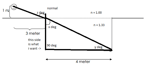

And if the ray just grazes the edge of the pool, I then get this:
Diagram of a light ray from a point above a water surface (n = 1.00 above, n = 1.33 below) refracting at the surface, with angles z, x and y marked, a 1 m vertical height, a 3 m horizontal distance, a 4 m base, and a 90 degree right angle at the bottom left corner.
which would make by original attempt not work. Basically the only thing I need now is either x or y (degrees) and with it I can calculate the side (depth). But using Snell's law, now I only know the n's, not the angles. So I have two unknowns. How should I proceed?

Ray diagram of a light ray refracting at a water surface: a source 1 m above the water on the left travels down to the water, bends toward a vertical normal, and reaches a point 4 m horizontally away at the pool bottom. Labels: z deg, x deg, y deg, 90 deg, 3 meter, 4 meter, n = 1.00 above, n = 1.33 below.
Do you know trigonometry?
You can get sin(z) by using the Pythagorean theorem. Otherwise, use a scientific calculator to find the angle z
Then use Snell's Law , etc.
Hello, yes I forgot that! I calculated z degrees and then got x to be 45 degrees (making y also 45). So the depth is the same as the base of the triangle, approx 4 meters.
Yes, approximately 45° , so approximately 4 meters deep.
