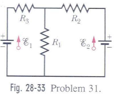

I have a circuit problem I'm having trouble with. I've attached an image of it.
Emf_1 = 3 V; Emf_2 = 1 V; R_1 = 5 \Omega; R_2 = 2 \Omega; R_3 = 4 \Omega
Both batteries are ideal. a.) What is the rate at which energy is dissipated in R_1?
Since P = i^2R, I figured that I should find the current. I used the loop rule (I'm not sure if I should have done this or not). I started at a point between emf_1 and R_3. I pretended the current was pointed downward at emf_1 and upward through R_1 and R_2. I called those last two currents i_1 and i_2, respectively. i_{total} = i_1 + i_2.
For the inside (left) loop:
R_3i_{total}+R_1i_1+emf_1 = 0
For the outside loop:
R_3i_{total} + R_2i_2-emf_2+emf_1 = 0
+R_3(i_1+i_2)+R_1i_1 = -emf_1
-R_3(i_1+i_2)-R_2i_2+emf_2=-emf_1
(5\Omega)i_1-(2\Omega)i_2 = -7 V
-(4\Omega)(i_1+i_2)-(2\Omega)i_2 = -3 V
-(4\Omega)i_1-(6\Omega)i_2 = -3 V
I solved the system of equations and ended up with i_1 = 0.95 A. This isn't the correct answer, because i^2R ends not equalling 0.346 W, which is the right answer.
I have the feeling I did something really wrong. Did I make it way too complicated? I have a tendency to overdo things
