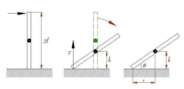

An upright standing rod of mass m and length 2l receives a small push at the top and falls.
The floor is smooth. the height of the center of mass at any given time is h, according to the drawing.
Show that the velocity of it's center of mass is:
[tex]V=(l-h)\sqrt{6g(l+h)/(4l^2-3h^2)}[/tex]
[tex]M=I\alpha[/tex]
Because all forces are vertical, I assume the center of mass will move directly vertical, under it's initial location, as in the drawing.
The horizontal distance between the reaction of the floor F and the center of mass is:
[tex]x=lcos\theta=l \sqrt{1-sin^2\theta}=l \sqrt{1-\frac{h^2}{l^2}}=\sqrt{l^2-h^2}[/tex]
[tex]\left\{\begin{array}{l}mg-F=ma\\F\sqrt{l^2-h^2}=\frac{4}{3}ml^2\alpha<br /> \\a=\alpha l\end{array}[/tex]
From those:
[tex]a=\frac{3g\sqrt{l^2-h^2}}{4l+3\sqrt{l^2-h^2}}[/tex]
And now:
[tex]V=\int_{l}^{h}\frac{3g\sqrt{l^2-h^2}}{4l+3\sqrt{l^2-h^2}}dh[/tex]
Which, I tried, doesn't yield the required result.
Hi Karol! :smile:
(have a theta: θ and an alpha: α and a square-root: √ :wink:)
a is not αl :redface:
(also, conservation of energy might be easier :wink:)
(and you could have got x = √(l2 - h2) directly from Pythagoras!)

I tried:
[tex]h=l\sin\theta\Rightarrow\dot{h}=l\dot{\theta}\cos\theta\Rightarrow\ddot{h}=l\left(\ddot{\theta}\cos\theta-\dot{\theta}\sin\theta\right)[/tex]
Together with:
[tex]mg-F=m\ddot{h}[/tex]
And:
[tex]M=I_c\ddot{\theta}\Rightarrow F\sqrt{l^2-h^2}=\frac{1}{12}m(2l)^2\ddot{\theta}[/tex]
I can't get anything.
h' = lθ'cosθ => h'' = l(θ''cosθ - θ'2sinθ) :wink:
BUT I seriously suggest that you use conservation of energy …
that only involves θ', with no θ'', which is obviously easier,
and it gives you the required answer for V directly :smile:
Energy:
[tex]mgl=mgl\cdot\sin\theta+I_c\ddot{\theta}^2[/tex]
I can't solve it for the function [itex]\theta(t)[/itex].
uhh? :confused:
how did you get θ'' into the energy?
(and how did you get g twice?)
start again :smile:
Correction:
[tex]mgl=mgl\cdot\sin\theta+I_c\dot{\theta}^2[/tex]
The [itex]mgl\cdot\sin\theta[/itex] is the new height of C.M. while in motion
what about 1/2 mvc.o.m2 ?
[tex] mgl=mgl\cdot\sin\theta+\frac{1}{2}m\dot{\theta}^2\cos^2\theta+<br /> \frac{1}{2}I_c\dot{\theta}^2[/tex]
Yup! :smile:
Now write cosθ in terms of l and h, and that should give you the required equation for V. :wink:

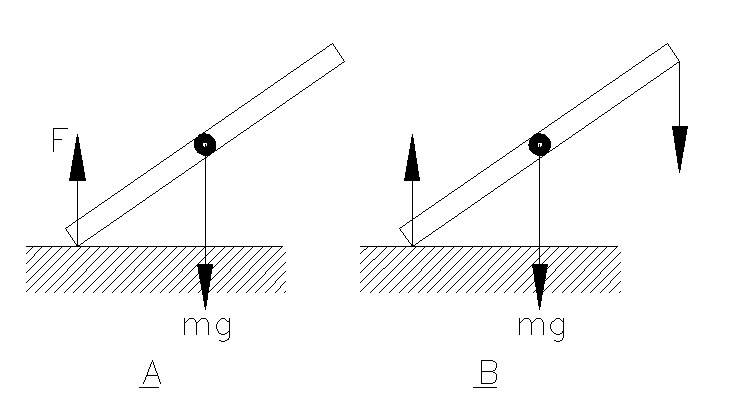

I assume the rod is rotating round it's bottom since the forces are according to picture A, attached here.
If the forces were according to picture B-then it would have rotated round it's center, am I correct?

Hi Karol! :smile:
Your conservation of energy equation doesn't seem to have a 1/2 Iω2 in it. :confused:
Are you talking about the instantaneous centre of rotation? :confused:
If so, that's somewhere between the centre and the end of the rod (because the centre is moving down, and the end is moving to the left).
Anyway, always take moments about the centre of mass unless you're certain you know where the instantaneous centre of rotation is.
EDIT: oops, I got a bit confused :redface: … the option in that last sentence applies to τ = Iα equations.
For a conservation of energy equation, if you're using 1/2 mv2 + 1/2 Iω2, you must use the centre of mass.​

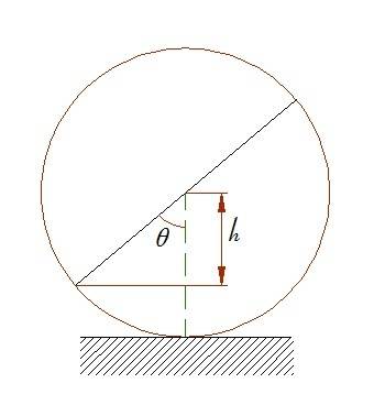

According to the new drawing, the height h is:
[tex]h=l\cos\theta\rightarrow\dot{h}=-l\dot{\theta}\sin\theta=-l\dot{\theta}\frac{h}{l}<br /> \rightarrow\dot{\theta}^2=-\frac{V^2}{h^2}[/tex]
So:
[tex]mgl=mgl\frac{h}{l}+\frac{1}{2}mV^2+\frac{1}{2}\frac{1}{3}4ml^2\dot{\theta}^2=<br /> mgl\frac{h}{l}+\frac{1}{2}mV^2-\frac{1}{2}\frac{1}{3}4ml^2\frac{V^2}{h^2}[/tex]
Which is not correct.
But it can not be correct since, you say, the instantaneous center of rotation changes it's place relative to the length of the rod all the time, so which I do I take?
Why are you using a new diagram? You've changed θ for 90° - θ, and then forgotten you've done it! :rolleyes:
(Also, you need I for the centre of a rod, not the end).
Try again. :smile:
