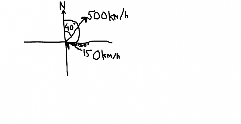

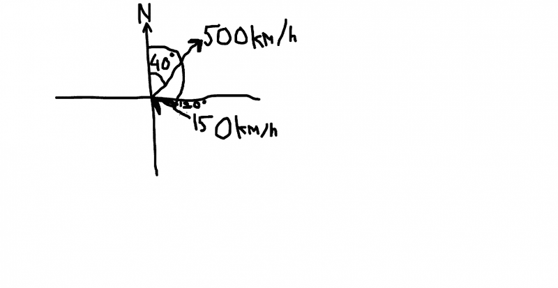

Question: An airplane is flying at an airspeed of 500 km/h, on a heading of 040 degrees. A 150 km/h wind is blowing from a bearing of 120 degrees. Determine the ground velocity of the airplane and the direction of flight.
____________________________________________________________________________________________________________________________________
The diagram: View attachment 96252
_____________________________________________________________________________________________________________________________________
I forgot to add the resultant but that would be just the missing side to form the triangle.
OK. If you put the tail of the blowing vector at the origin, what acute angle does the 500 km/h vector make with the positive x direction, and what acute angle does the 150 km/hr vector make with the negative x axis?
  • #32
If I put the tail of the wind vector at the origin, then it makes an acute angle of 30 degrees with the negative x-axis, and the plane vector will make an acute angle of 50 degrees with the positive x-axis.
  • #33
Good. Now, from the picture, what are the signs of the x and y components of the 500 km/h vector?
What are the signs of the x and y components of the 150 km/h vector?
  • #34
For the wind vector, the x component would have a negative (-) sign and the y component would have a positive (+) sign. For the plane vector, the x-component would have a positive (+) sign and the y component would have a positive (+) sign.
  • #35
Excellent. Now, can you use trigonometry (with the angles 50 degrees and 30 degrees for the two vectors) to get the x and y components of each of the two vectors?
  • #36
For the wind vector, the x component is 129.90 km/h and the y component is 75 km/h. For the plane vector, the x component is 321.39 km/h and the y component is 383.02 km/h.
  • #37
The magnitudes of these components are correct, but you already said that the sign of the x component of the wind is negative. So, what is the x component of the wind, with the correct sign?
  • #38

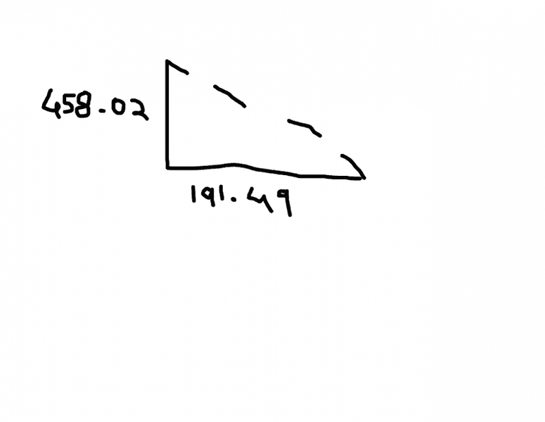

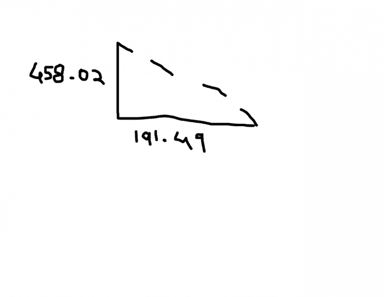

It would be -129.90 km/h. At this point I would total the x components and total the y components to get a total of 191.49 km/h for the x components and a total of 458.02 km/h for the y components. This will form a triangle (for the totals) that will look as follows:
The remaining side will be the resultant so I will use Pythagorean theorem to find it, so-
r=square root (458.02^2+191.49^2)
r=496.44
Therefore, the magnitude of the resultant will be 496.44 km/h. Now, in terms of the angle, I don't know which of the two angles will be the one.
  • #39
r=496.44
What is the angle that the resultant makes with the negative x axis?
  • #40
Would it be the one on the lower right?
  • #41
I don't know what this means. I get an angle of about 67.4 degrees between the resultant and the negative x axis.
  • #42
Yes, I got 67.3 degrees.
  • #43
OK. Now going around clockwise from North, the negative x-axis is at a bearing of 270 degrees (due West). That would be at 9 o'clock. But the resultant vector is even further clockwise than this, more towards 11 o'clock. So what is the bearing of the resultant vector?
Chet
  • #44
Would it be 337.3 degrees?
  • #45
Sure. Now we're done. Pretty easy, huh? Want to try another case?

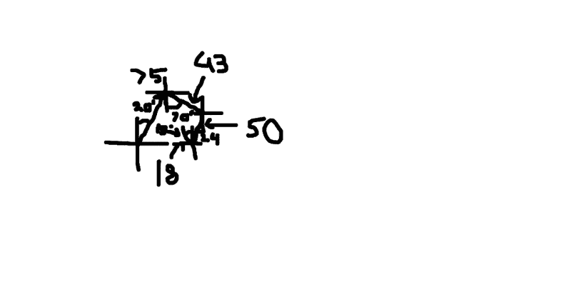

Yeah, that wasn't as bad as I thought it was. Yes, sure, let's try another case. Here's another question (not plane/wind but it involves the same concept of vectors):
_______________________________________________________________________________________________________________________________________
While on a search and rescue mission for a boat lost at sea, a helicopter leaves its pad and travels 75 km at N20E, turns and travels 43 km at S70E, turns again and travels 50 km at S24W, and makes a final turn and travels 18 km at N18W, where the boat is found. What is the displacement of the boat from the helicopter pad?
  • #47
OK. So now you have 4 vectors. First draw your diagram with the tail of each vector at the origin. Then, what is the acute included angle that each vector makes with the x axis?
  • #48
This is very messy, so it may be hard to see what's what.
Vector 1 makes an angle of 70 degrees with the x-axis; vector 2 makes an angle of 47 degrees with the x-axis; vector 3 makes an angle of 66 degrees with the x-axis; and vector 4 makes an angle of 72 degrees with the x-axis.
  • #49
The angle for vector 2 is incorrect. Also, I recommend plotting each of the vectors with its tail at the origin. This will make it easier to figure out the components.
  • #50
My bad, the angle for vector 2 (in relation to the x-axis) is actually 20 degrees. Also, just curious, why are we shifting the vectors such that the tail is at the origin (for this question and for the previous one)?
  • #51
We shift the vectors because it makes it easier to visually see the horizontal and vertical components, and the angles.
20 degrees is correct.
Now, for each of the 4 vectors, from what you see in the diagram, what is the sign of the x component and the y component.
  • #52
For vector 1, x and y both are positive; for vector 2, x is positive and y is negative; for vector 3, x and y both are negative; for vector 3, x is negative and y is positive.
  • #53
Excellent. Now get the x and y components of each of the 4 vectors, including the correct signs.
  • #54
For vector 1, the x is 25.65 and y is 70.48; for vector 2, the x is 40.41 and y is -14.71; for vector 3, the x is -20.34 and y is -45.68; and for vector 4, the x is -5.56 and y is 17.12.
