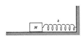

The block shown in the drawing is acted by a spring with spring constant ##k## and a weak friction force of constant magnitude ##f##. The block is pulled a distance ##x_0## from equilibrium and released. It oscillates many times and eventually comes to rest.
a. Show that the decrease of amplitude is the same for each cycle of oscillation.
b. Find the number of cycles n the mass oscillates before coming to rest.
(Ans. ##n=\frac{1}{4}[(kx_0/f)-1] \approx kx_0/(4f)##)

  • Diagram of a block of mass M on a horizontal floor, attached to a spring of constant k whose other end is fixed to a wall on the right.
Does ##f## always act in the same direction?
Also, What direction does the friction act just after being released?

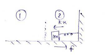

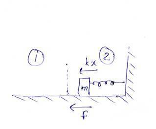

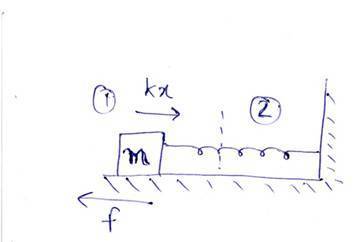

I am not sure so I will start with the FBDs. (The friction shown acts on the block, not on the ground, the dotted line shows the equilibrium position)
When the block is released from the initial position,
Hand-drawn free-body diagram of a block of mass m on a horizontal surface attached to a spring, with a dashed equilibrium line; labels show kx pointing right, friction f pointing left, and regions 1 and 2 marked, with a wall on the right.
When the block enters the region 2,
Hand-drawn sketch of a block of mass m on a horizontal surface attached to a spring anchored to a wall on the right, with friction f acting left and spring force kx acting left; regions 1 and 2 are labelled, and a dotted line marks the equilibrium position.
The spring compresses to a maximum and the block starts to move towards left. While the block is in region 2, the fbd is as follows
Hand-drawn free-body diagram of a block of mass m on a horizontal surface attached to a spring, with a wall on the right. Region 1 is on the left and region 2 is near the wall. Arrows show a spring force kx pointing left and friction f pointing right, with a dashed vertical line marking the equilibrium position.
When the body finally reaches back into region 1,
Hand-drawn free-body diagram of a block of mass m on a horizontal surface attached to a spring anchored to a wall on the right, with a dashed equilibrium line, region labels 1 and 2, the spring force kx to the right, and an applied force f pointing right below the block.
Are the FBDs correct? How should I form the equation of motion now? Should I separately apply the Newton's second law for each situation I have shown?

Your original differential equation is incorrect. There should be a +f, rather than -f. Redraw the figure with the x-axis pointing in its usual orientation, and you will see what I mean. Write out the correct solution to the differential equation. Then calculate the location of the block 1/2 cycle later when its velocity reverses direction. What is its location then? How much has the amplitude decreased during this half cycle. Does this decrease in amplitude depend on x0? If not, then the amplitude will decrease by this same amount every half cycle.
You may find that an energy approach is fairly straightforward, rather than trying to write several differential equations to account for changing frictional force direction.
Suppose the spring is stretched leftward from equilibrium by ##x_o##. The system is then "armed" with potential energy in the spring. When released, the block will move to some maximal location on the other side of the equilibrium point before springing back. Can you work out that distance by considering energy?
Do the same for the return journey.
