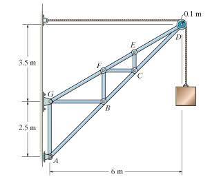

Determine the largest mass m of the suspended block so that the force in any member does not exceed 52 kN(T) or 47 kN(C).
ƩM = 0
ƩFy = 0
ƩFx=0
Did I assume the arrows right?
Would this be the right track to solving this?
Solve for each piece.
Sum of moments, and solve for m?

All the back of the book says is:
Joint D: (F_DC)sin45 + (F_DE)cos30.25 - W = 0
Joint A: F_AG - 1.414Wsin45 = 0
Thanks for the detail Hibbeler.

If points E and C were attached/hinged to a wall, could you analyse CD and ED.
The scale of the diagram will show you how far apart E and C are - there is a 45o angle in there.
Solved it
