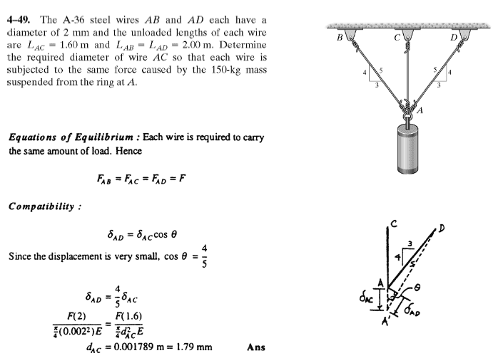

In this question , I am not convinced that δAD = δAC cos theta
, i think it should be
δAC = δAD cos theta , am i right ?
I think so because we normally get the non-vertical and non -horizontal line and then cos the angle or sin the angle to get the length in x and y direction , right ?

No. You're not right. Call L the distance between C and D. Does this distance change?
no
no , the distance doesn't chnage , so ?
Call x the distance from A to C. Using the Pythagorean theorem, in terms of L and x, what is the distance between A and D?
AD = sqrt ( L^2 + x^2 )
Good. Now, if the distance between A and C changes by dx, in terms of L, x, and dx, by how much does the distance between A and D change?

Apparently, that wasn't a big enough hint. What is the derivative with respect to x of ##\sqrt{L^2+x^2}##?

As far as the derivative of ##\sqrt{L^2+x^2}## is concerned, you obtained:$$\frac{x}{\sqrt{L^2+x^2}}$$Is that what you meant?

You still don't see it, huh?
Well, if dx is the change in the length of AC, then the change in length of AD is ##\frac{x}{\sqrt{L^2+x^2}}dx##.
Or equivalently, if ##\delta_{AC}## is the change in length of AC, then the change in length of AD is ##\frac{AC}{AD}\delta_{AC}##:
$$\delta_{AD}=\frac{AC}{AD}\delta_{AC}$$
But,$$\frac{AC}{AD}=\cos{\theta}$$
Therefore,$$\delta_{AD}=\delta_{AC}\cos{\theta}$$

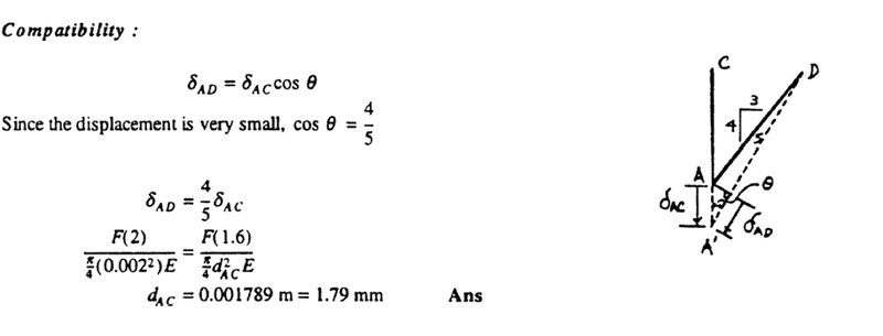

ok , but , i still dun know why Ac = Ad cos theta , where theta is between AC and AD ... because normally , we will make the 'slanted line ' to get the horizontal x -direction and vertical (y-direction ) , am i right ?
one more thing, how could AD = AC cos theta , where cos theta = 4/5 ,
it's given that AD = 2 , AC = 1.6 AC cos theta = 1.6(4/5) = 1.28 which is not = AD (2m)
i don't understand this part , we know that δ = PL / AE , we also know that δAD = (4/5)δAC , so , shouldn't (4/5)δAC = (4/5)(1.6) / AE ?

$$AC=x$$
$$\delta_{AC}=dx$$
$$AD=\sqrt{L^2+x^2}$$
$$\delta_{AD}=d\sqrt{L^2+x^2}=\frac{x}{\sqrt{L^2+x^2}}dx=\frac{AC}{AD}\delta_{AC}=\frac{1.6}{2}\delta_{AC}=\frac{4}{5}\delta_{AC}$$
it's given that AD = 2 , AC = 1.6AC cos theta = 1.6(4/5) = 1.28 which is not = AD (2m)
Who said AD=AC cos theta?
I said ##\delta_{AD}=\delta_{AC}\cos{\theta}##
