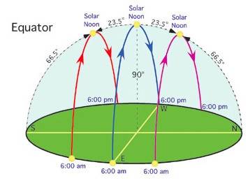

This picture, taken from a meteorological web page, helps to understand why the sun, as seen by an observer at the equator, has apparent paths of equal duration through the year, but rises and sets in the east/west only in the equinoxes (blue line). In the solstices (red lines), it rises and sets at points not exactly east/west, but deviated 23,5º to the north or to the south, depending on the sign of the extreme declination of the sun:
  • #53
The above diagram, and many others like it on the internet is factually incorrect. Just look at those idiotic 90° angles at the two solstices. The only time that the Sun's path ever intersects the horizon at right angles is during the equinoxes. Again, I do not want you to take my word for it. Ask any astronomer! During these equinoxes, every place that gets twelve hours of daylight will see the Sun rise directly east and set directly west. The laws of spherical trigonometry require it!
The circle of illumination is a great circle. Agreed? The Equator is a great circle. Agreed? The principles of spherical trig mandate that any intersecting great circles will cut one another in half. That is why the period of daylight is always the same on the Equator at any time of year. Agreed? This means that when you are on the Equator, the sun will always make an 180° path through the sky. Agreed?
Look at the diagram. Do the three paths seem the same length to you? Of course not! Therefore, since the Sun's movement through the sky is always 15° per hour, the red path and the violet path are too short to be accurate. Spherical trig will tell you that there is no way for the Sun to trace an 180° path through the sky unless it starts at due east and ends at due west.
Why are you unwilling to accept the testimony of hundreds of millions of people who live on or near the Equator and will readily tell you that the Sun rises in the East and sets in the West (give or take a fraction of a degree) every day of the year? Ask any of the more than a million people who live in Quito, only 22 km from the Equator.

You are way off base here, klimatos. The diagram posted by NTW is factually correct.
This is the source of your error:
klimatos said:
The Sun's path through the sky (including the path below the horizon) is also a great circle.
That is not true. The path of an object on the celestial equator through the sky is a great circle. For an object that isn't on the celestial equator, the path of that object through the sky is a small circle rather than a great circle. For example, the path of Polaris (Alpha Ursae Minoris, aka the North Star) through the sky obviously is a tiny, tiny little circle about true north.
At the equator, the Sun is always in the southern half of the sky at this time of year, even when it's underfoot. The Sun does not make a great circle. The Sun is about 11.5 degrees south of the celestial plane at this time of year (late October). People on the equator will see the Sun rise 11.5 degrees south of east and set 11.5 degrees south of west.
At the equator, the Sun is always in the southern half of the sky at this time of year, even when it's underfoot. The Sun does not make a great circle. The Sun is about 11.5 degrees south of the celestial plane at this time of year (late October). People on the equator will see the Sun rise 11.5 degrees south of east and set 11.5 degrees south of west.Let's do just that. From http://www.timeanddate.com/astronomy/ecuador/quito, the Sun rises today (October 23, 2014) at 5:55 AM at an azimuth of 101° (11° south of due east) and sets at 6:02 PM at an azimuth of 258° (12° south of due west). Note the 11° (sunrise) and 12° (sunset) offsets. Those are due to the current 11.5° declination of the Sun.
I stand corrected, and I apologize for my arrogance, especially to NTW. Damn! I was so cocksure that my logic was impeccable, despite NTW's best efforts to show me my error. There must be something wrong with my mental three-dimensional imaging. But that's no excuse. The evidence from the Quito Observatory is irrefutable. Mea culpa!
  • #59
Graeme M said:
Well, this thread has gone astray but it's very interesting. I can't at all visualise what is being discussed nor how it relates to my original question, and I definitely can't tell whether NTW or klimatos is correct. But one small question re DH's comment above. I think I dimly see what you are saying re the apparent path of distant objects such as the north star. But I can't see it's a valid comparison. In effect, those distant objects appear as points on a large 'background sphere' around the Earth and hence their paths will depend on both the rotation of the Earth and the axis of that rotation in relation to the background sphere. But the sun is a different kettle of fish. The Earth revolves around the sun, the sun is not in effect part of the background sphere. Doesn't that make the relationship between earth/sun rather different from that of earth/distant object?
The sun is a very bright celestial body, and with a large disk, perceptible to the unaided eye. But it's just -with the Moon and the planets- another celestial body that 'wanders through the skies'. That's the only difference with the stars, that have -save for a small 'proper motion' measurable in some- fixed positions in the celestial sphere. On the other hand, the sun, the moon and the planets have variable positions, as their equatorial coordinates change constantly.
Of course, we don't live in a geocentric universe, but it is a useful way of visualizing those things.
Having said that, I feel happy that klimatos has finally understood the problem of the sun's apparent path... Thanks, klimatos...!
