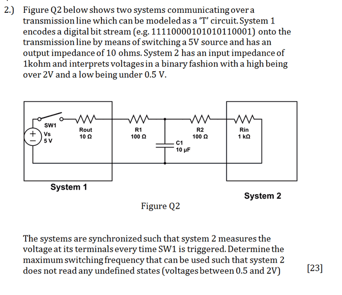

Problem and Diagram stated below
System 2 Input Impedance: 1k ohms
System 1 Output Impedance: 100 ohms
High interpreted as Voltage greater than 2V
Low Interpreted as Voltage less than 0.5V
Capacitor Charging eqn:
V=Vo(1-e^-t/RC)
Capacitor Discharging eqn:
V=Voe^-t/RC
f=1/T
Posted Below

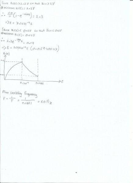

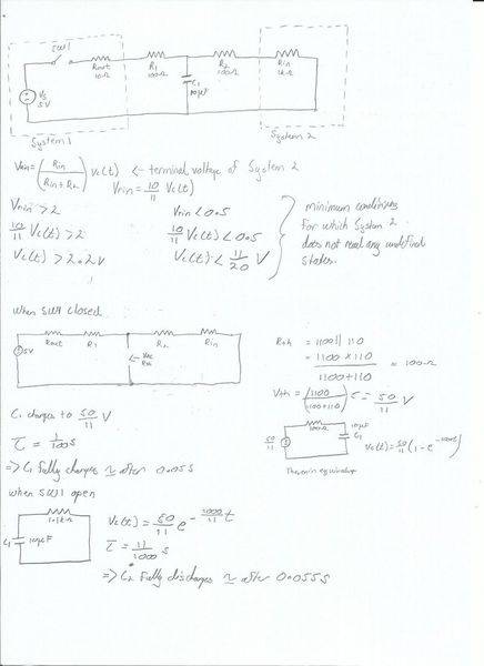

Hey guys. This was a problem given to us on one of our assignments and that was my suggested solution...was wondering if what I did was correct.
Thanks in advance :D

Long story ! Some comments:
First thing that comes to mind for me is the ##\tau## : you sure it's from the 100 Ω only and not the 110 Ω ? (test: let Rin = 1M Ω !)
Second: no need for the ##\approx.## sign. Everything is given 'exactly'. Idem for increasing the 2 * 11/10 to 2.3 and decreasing the 0.5 * 11/10
As BvU points out, you need to take a closer look at how you determine ##\tau##. Suggestion: find the Thevenin equivalent that the capacitor sees. Note that this will include the load-side resistors too!
Good thing gn is on the lookout ! I had forgotten those load side guys. Rustiness...
