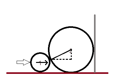

I drew what I thought the FBD would look like on the topmost object only including Normal force and weight, by this I think the weight is not affected.Pic 2: If there is an horizontal force, does the horizontal force go to the middle of the larger circle on an angle or does the force continue horizontally and only apply at the bottom of the larger circle? Also is it possible to lift the larger circle vertically with a horizontal force?
I drew what I thought would happen to the applied force horizontally.

2. In pic 2, if there is an horizontal force, does the horizontal force go to the middle of circle two on an angle or does the force continue horizontally and only apply at the bottom of circle two? Also is it possible to lift the second circle vertically with a horizontal force?
