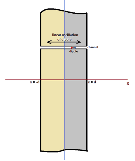

I already mentioned the position of the dipole. Let me attach a picture to make things more understandable. The charges of the dipole are on the opposite sides of the imaginary vertical line passing through x=0.
(The distance between the charges of the dipole was not given in the question and it was assumed here. Because in the end, q*l will give p and p was given in the question)

  • #35
(The distance l between the charges of the dipole was not given in the question and it was assumed here. Because in the end, q*l will give p and p was given in the question)
That's fine if we assume l → 0 so both dipole charges see the same E field. If this is not assumed then the problem becomes more complicated. If l is finite then in order for a uniform E field for the dipole, the dipole must be centered at x=0.

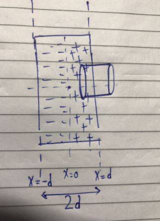

You picked the wrong Gaussian cylinder.
One end is at x > d and the other end is at x, -d < x < d.

  • #41
Is this the gaussian surface you were talking about?
  • #42
  • #43
The magnitude of forces on both the charges of the dipole will be equal as they're at an equal distance from the centre. I am sure about this.
Talking about the gaussian surface,
What will be the gaussian surface, we use the formula ∫E.ds = 4πq or q/ε
Here, the what will be E through the right face of the cylinder? Would the + charge that is on the right hand side of the plate, be distributed on the right outside surface of the plate too? If that is the case, then Φ1 would be Eds (+x direction)
and through the left surface also it would be the same.
The net flux will then become 2E.ds
Now, we are given volume charge density which is uniform. What value of q will we take on the right hand side?
Because q is the total charge contained inside our gaussian cylinder. And charge distribution is non uniform.
  • #44
OK. Very important & I did not see this until now.
?? It is not uniform. It varies with x.
You need to calculate the total charge within the gaussian surface. You also need to know E at the right-hand end at x > d. Then you get E at the left-hand end which is anywhere within -d < x < d. So then you know E(x) for all x, -d < x < d.
Yeah, non-uniform. That is what I intended to write, was a typo.If we keep left face of the gaussian cylinder inside the positive half of the plate, the flux through that surface would be E.ds and would be positive.
If we keep left face of the gaussian cylinder inside the negative half of the plate (i.e. to the left of x=0), then the flux through that surface would be negative as E and ds would be in opposite directions.
So, how to decide where will the left face of our gaussian cylinder would lie?
  • #47
If the cylinder extends from x to +∞, what is the total charge inside it?
  • #48
E and ds are in the same direction in the entire region -d < x < d. So E⋅ds is positive everywhere in the region. The E field is in the -x direction everywhere in the region. This may not be intuitive but it's true because the plates are infinite in extent.
The net charge in the gaussian cylinder you depict is either + or 0, never - .
