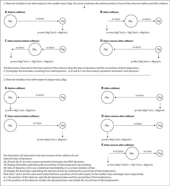

  • #31
There's a lot of unexpected confusion or ambiguity in the premise of my question.
Obviously I didn't pose it as concise as I should have.
My question comes down to this: the "measured" exchange of momentum
between differing masses in collisions of uniform motion, is(appears to be) a relative
measure that upholds or violates the laws through time reversal depending on the
frame of the observer.
The inertial energy (rest mass) of a small mass will not overcome (is less than) the
energy of momentum of a larger mass, therefore the small mass at rest will not bring
the larger mass in motion to rest.
When collisions of this type (ideal, inelastic collisions of rigid, non-composite bodies -
hypothetical events designed for the purpose of considering the principles of the laws,
not the real mechanics of the event)
are observed from a position of rest with respect
to each of the two masses involved, Newton's laws are upheld and Einstein's SR principle
of relativity accounts for the differing but valid observations between each observer.
To test the extent of the principle of these classical laws, I considered the same events reversed in time.
One would assume the second law of thermodynamics predicts the exchange of
momentum is both conserved and leads to observable "decrease" in entropy under
time reversal. Which is to say the law of inertia would simply reverse such that a
small mass would bring a larger mass to rest - a clear indication of the reversal
of the second law.
This is in fact the case when the observer is initially at rest with the larger mass.
It is not the case when the observer is initially at rest with the smaller mass.
The statistical nature of the second law is irrelevant to this asymmetry as this
inconsistency is directly correlated to the masses involved.
My question is whether there is any known reason this symmetry holds from
one frame (larger mass) and fails from the other (smaller).
At first glance it appears this asymmetry suggests time-reversal reveals a preferred
or privileged frame of reference. It seems to suggest the dynamical laws are upheld
only when one of the masses (either) is defined as the mass in motion.
In other words the relativity of momentum is not as clear cut as the relativity of motion.

I do and I would until I thought about this example and the time-reverse dynamics required to explain it.
1.
A large mass M is moving with constant velocity v toward a small mass m as measured by an observer R
initially at rest with respect to m.
After a collision through the center of their masses, R measures the velocity of M to be 1/2v and the velocity of m to be v.
Now take the time reverse this event.
2.
R observes the large mass M moving toward him at 1/2v and the smaller mass m moving toward him at v.
M and m collide and m comes to rest with respect to R and M continues at v.
The forward and time-reverse of this event holds to the laws mechanics.
If you could view the time reverse version it would appear as any natural collision of the same proportions forward in time.
Now place the observer initially at rest with respect to M and they observe the following.
3.
The smaller mass m moves toward R and M with velocity v.
After the collision, m is at rest with R and M moves away at 1/2v.
Now take the time reverse of this event.
4.
R observes M moving toward m at 1/2v.
After the collision M is at rest with R and m moves away at v.
Under these mechanics, all large masses should come to rest upon colliding with smaller masses.
So it would seem (4.) is correct in that a reversal of time should result in the reversal of the second law and the converse of the law of inertia.
The problem is with (2) as it presents mechanics that uphold the second law under time-reversal and the law of inertia.
That they differ is my point. They differ when they are the "same" event viewed from different inertial frames.

Hi Chrisc,
Your right. I was a bit confused about what you were getting at and after checking it all out again I think I have a better handle on it now and it turns out the calculations in your diagram are correct for a inelastic collision.
The solution to the apparent paradox is this.
First case (observer is initailly at rest with the small ball)
Total momentum of the system before and after collison is 4mv.
Total KE before collision is 4 mv^2
Total KE after collision is 3 mv^2
There is a loss of 1 mv^2 as heat during the collision. When the process is time reversed the system starts with 3 mv^2 of energy and finishes with 4 mv^2 of energy so an input of heat is required and this is shown as the freak lightning bolt that hits the balls as they collide in the attached diagram.
Second case (observer is initially at rest with the large ball)
Total momentum of the system before and after collison is 2mv.
Total KE before collision is 2 mv^2
Total KE after collision is 1 mv^2
There is a still a loss of 1 mv^2 as heat during the collision. When the process is time reversed the system starts with 1 mv^2 of energy and finishes with 2 mv^2 of energy and this is again shown as the freak lightning bolt that hits the balls as they collide in the attached diagram. It is the additional energy supplied by the lightning bolt that brings the large ball to a complete stop.
The thermodynamic arrow of time is clear here. It is statistically unlikely that heat (or lightning) from the surrounding environment concentrates and imparts coherent momentum to the large ball exactly as required at the moment of collision in the reverse time scenario. Or as George would say, "it's not going to happen" :P
Perhaps I should add that the results are consistent from which ever inertial reference frame you look at it from. All the velocities in the second case are simply the velocities in the first case minus 2v. Also it should be clear that inelastic collisions are not time reversible in general.

The time-reversed version would be mechanically possible, but it would also be a "thermodynamic miracle" since it would require a huge number of random vibrations in the molecules of the objects (heat) to all coincidentally synchronize at the moment of the collision and increase their combined kinetic energy in this frame, from (3/8)*Mv^2 to (4/8)*Mv^2.

I don't follow. The time-reversed scenario (2) violates the second law just like the time-reversed scenario (4); each one involves heat being spontaneously converted into extra kinetic energy for the center of masses.

Kev and JesseM, you've both taken this out of its original context.
I had qualified this as a system of rigid, non-composite bodies in order to simplify and focus the
dynamics by removing molecular motion (heat). The idea is to consider the principle of the laws
by examining the exchange and/or conversion of the energies involved (mass, inertia and momentum) through time.
It would be "a miracle" for the constituent particles of a body to align their momentum in such a way
as to "kick" an adjacent body (as a whole) into motion. But this "miracle" would happen in the time-reverse scenario.
It must happen if the laws are correct in the time forward scenario. This miracle is just a collective
molecular example of the simpler version I presented which is a smaller mass brings a larger mass to rest.
You have both described the mechanics that justify our concept of a thermodynamic "direction" of time.
The crux of what I'm trying to figure out is whether the principle of relativity posses enough symmetry
to survive a translation in time, i.e.: is the principle of relativity time-reverse symmetric?
In the observable mechanics of motion (relative velocity) it seems obvious it would. Velocity is kinematical,
as such there is no need to consider dynamics in a causal sense. So the time-reverse symmetry of the
kinematics of Special relativity seems pretty straight forward - it holds.
But, when mass is part of the consideration of the time-reverse symmetry of relativity, its measure and
