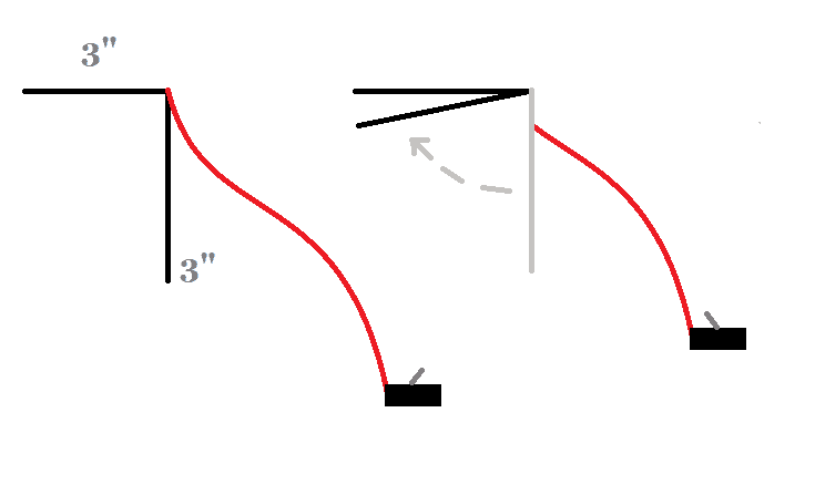

Hi everyone, learning a bit of hands on engineering and have no idea what to search in order to buy what is needed. I am looking for a motor that can be activated by a simple switch on a wire that will rotate a piece of metal 90 . degrees. Excuse the poor image but hopefully someone can point me in right direction for this project.
You are going to need more than just a switch and a motor, I think. The switch can tell the motor to turn but you have to have something to tell the motor to stop turning. How about the reverse? Do you want the piece to be able to rotate back to its original position?
Yeah basically to throw a switch that will move it 90 degrees one way and then flip it the other direction to move it 90 degrees back to the original starting position. Is there anything premade that might work for this?
Doesn't sound like anything I've ever heard of but just 'cause I don't know doesn't mean it doesn't exist.
Have you considered using a servo motor?
If the rods are hinged attach a large gear to one of them parallel to the horizontal i.e. like a hand grinder with 2 handles. Then connect a simple DC motor to it via a smaller gear. Use a 2 way switch to operate the motor.
If you need stops use limit switches and a few more wires
