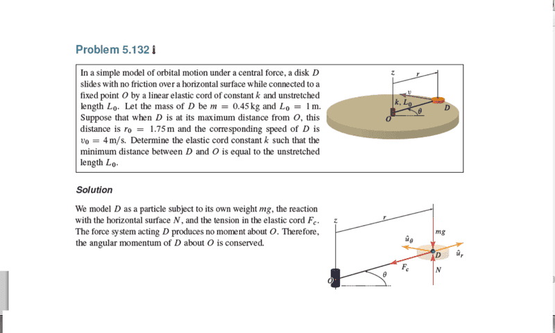

The discussion centers on understanding why a specific force system produces no torque about point O. Participants question whether the forces mg (weight) and N (normal force) generate torque around O. It is clarified that torque is calculated based on the perpendicular distance from the line of action of the force to the point of rotation. If the line of action passes through point O, no torque is produced, regardless of the forces involved. The conversation emphasizes the importance of analyzing the geometry of the force application to determine torque effects.

Why does the force system produce no torque about O
don't mg and N produce a torque about O?
How is torque about a point calculated?
