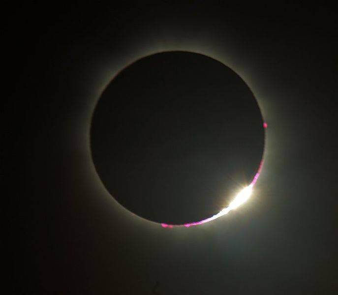

Andy Resnick said:
For the eclipse... I'm not sure what ND would be best- 4 may be too much. Maybe someone here with more experience can chime in...
Everything before totality you need full filtering
in the moments before totality ( to capture the "Bailey's Beads) and through totality you won't need any filtering
Then as totality ends put the filter back on and continue shooting the partial stage

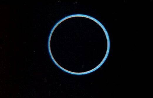

Annular Solar Eclipse I shot from Blenheim, NZ in 1991 using mylar film ... has a distinguishable blue tint

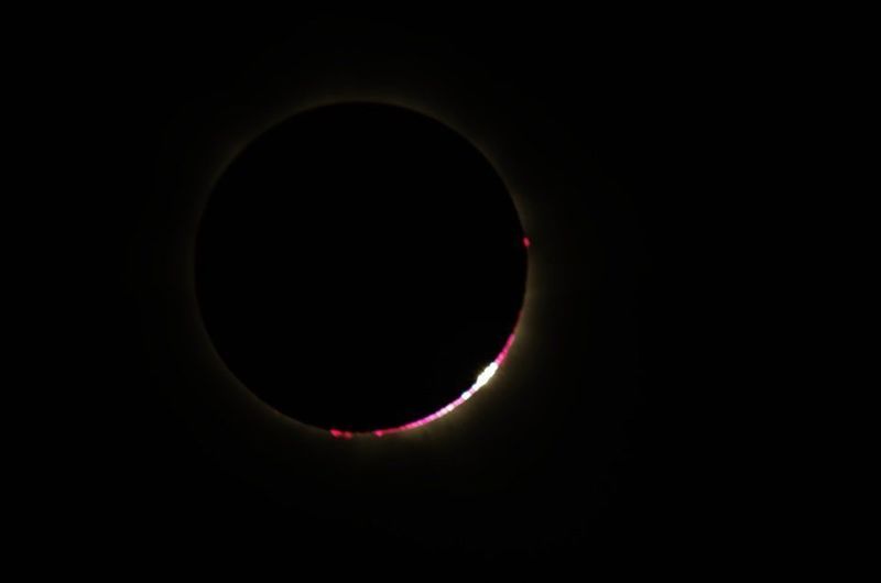

Cairns, Australia 2012 almost totality with Diamond Ring then Baileys beads ... no filter

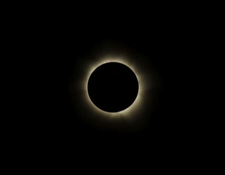

Totality, no filter, showing some of the Corona ... I could have easily slowed the exposure a bit and got a bit more corona
experiment with exposures of 50th - 100th of a sec and don't be afraid to push the ISO a little to around 200 - 400 to get enough light
hopefully that helps with a few ideas cheers

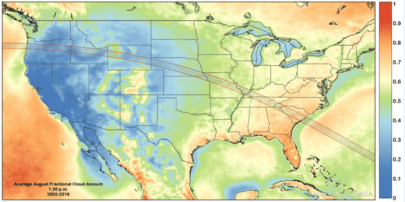

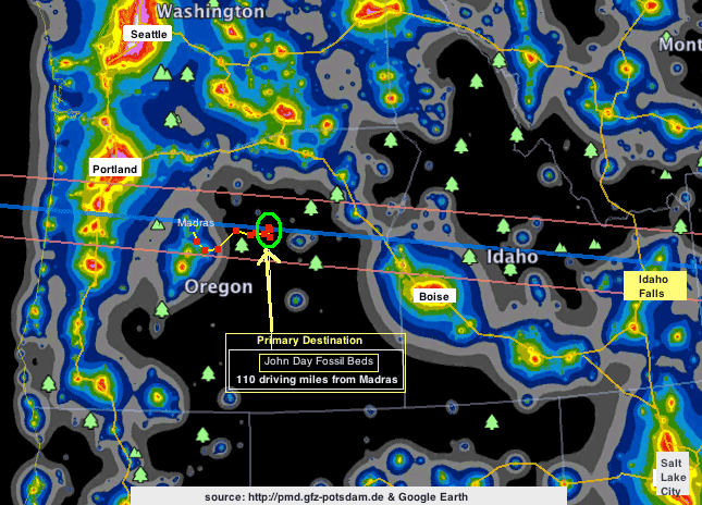

According to this graph, it's historically one of the best places in the nation to view the eclipse. (least chance of clouds)
The graph is from an interesting website, with WAY too much information: http://eclipsophile.com/oregon/

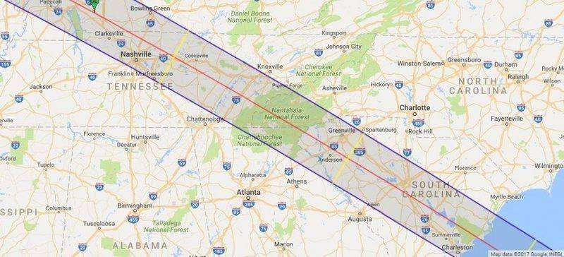

I live in Charlotte, NC. My strategy is plan A: drive to mid-South Carolina, or plan B: drive to Tennesse. This I will decide the day before after previewing weather reports. The Carolinas do have loads of cumulus clouds in the summer, more than clear blue skies. Afternoon thunderstorms, day after day, are common. Also, the east and west of the Appalachian mountains always seem to have exactly the opposite weather. Rain here means a drought there, or vica versa.
