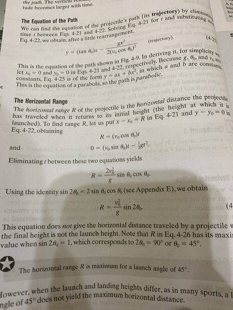

My question is when do we use the formula for R given above. Because we could have calculated the Rmax by ##R=(v0\cos(\theta))t## and then subtracted R from it to get the answer.
Why the x and y component in the derivation of this (R)formula are combined by eliminating t?

R is x when y = 0 again.
How do you know what t would have been for max range?
Btw, the given formula is only for when the trajectory starts and finishes at the same height.

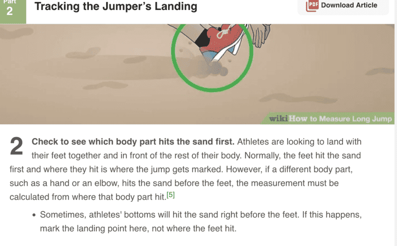

For a real world long jump, the landing position has the jumper's center of mass lower than at launch due to posture. One launches standing up. One lands as low as one can manage.
Also, the length of the jump is from the takeoff line to the point where the jumper's first body part touches the sand. The feet are considerably far ahead of the center of mass and that is why jumpers try to land with feet as forward as possible without their butt hitting the sand first.
Or after.
"Long jumps are measured from the forward edge of the take-off board to the impression in the landing pit closest to the take-off board made by any part of the body of the jumper."
jbriggs444 said:
Or after.
That contradicts what I found here. Goes to show how reliable the web is.
Adopting a "first point hit" marking policy would favor a strategy of laying out flat and, perhaps, bending the knees slightly to ensure a heel-first hit. This would also make measurement more prone to irresolvable dispute.
The reference I had found was here.

We need to find the max R which can be calculated by putting ##theta=45## in this formula. I guess we have to use this formula anyway.
In the derivation of the formula they took two eqns for s, one vertical and horizontal and eliminated t. So the whole point of this is to find R easily even when t is not given.
$$R=v0cos(theta0)t$$
$$0=v0sin(theta0)t- \frac12gt^2$$
$$R=\frac{v0^2}{g}sin2(theta0)$$
We don’t know t and theta both, Yes?
You already said that you know what theta needs to be to maximize R.
You had a perfectly good formula involving ##v_0## (known), ##g## (known), ##\theta## (known) and ##t## which you could easily solve for t:$$0=(v_0 \sin \theta)t - \frac12gt^2$$In fact, you did solve for ##t## and used the solution in your next equation.

As I posted, we first have to find t without using ##\theta=\pi/4##. We can do that by writing the two usual equations:
##y=v\sin(\theta)t-\frac 12gt^2##, ##x=v\cos(\theta)t##
Substituting y=0 to find the time when it lands:
##2v\sin(\theta)t=gt^2##, ##2v\sin(\theta)=gt##
Plugging that into the x equation:
##x=v\cos(\theta)2v\sin(\theta)/g=v^2\sin(2\theta)/g##
Now we can see x is maximised by ##\theta=\pi/4##.
The formula exists. It is your choice whether to remember it or to remember how to deduce it. I was never good at remembering formulae, but I could usually remember how to get them.
