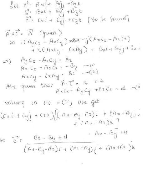

hi..i tried doing the question and have got an unusual answer..shown on the included attachment..The question said that the answer shud be in terms of A,B,d and magnitude of A.However mine isn't coming as shown..Plz help!Thanks!

I think you're going to have to flex your algebra muscles a little more. I really don't feel like solving the whole thing :redface: , but for [itex]C_x[/itex] I get:
[tex]C_x=\frac{da_x-a_yb_z+a_zb_y}{a_x^2+a_y^2+a_z^2}[/tex]
[tex]C_x=\frac{da_x-(\vec{A}\times\vec{B})_x}{|\vec{A}|^2}[/tex].
If the other components go by that pattern, and if I haven't made any dumb mistakes, then it should follow that:
[tex]\vec{C}=\frac{d\vec{A}-\vec{A}\times\vec{B}}{|\vec{A}|^2}[/tex].
Try to work it out, OK?
A.C=D
AxC=B
So we have
[tex](AXC)XA=|A|^2 C-(C.A)A=BXA[/tex]
So
[tex]C=\frac{BXA+dA}{|A|^2}[/tex]
heey..i tried working it now and got it...u knw what..the only thing was that everything seemed so abstract that it was confusing me like nething..i mean unknown components etc..
nehow..thanks again..
i finally got it!
