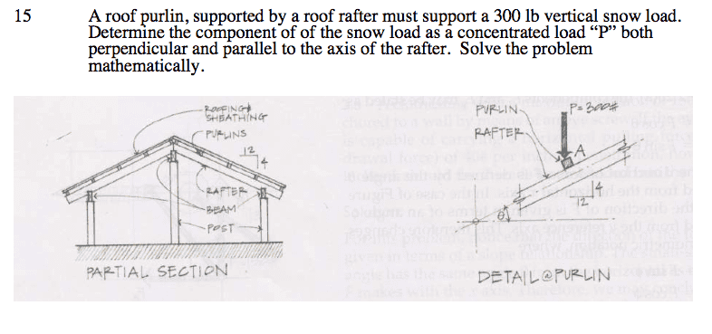

A roof purlin, supported by a roof rafter must support a 300 lb vertical snow load.
Determine the component of of the snow load as a concentrated load “P” both perpendicular and parallel to the axis of the rafter.
Handwritten problem sheet: a partial section of a roof showing roofing sheathing, purlins, rafter, beam and post, and a detail view of a purlin on a rafter with a 12-in-4 slope and a 300 lb load P arrow pointing down.

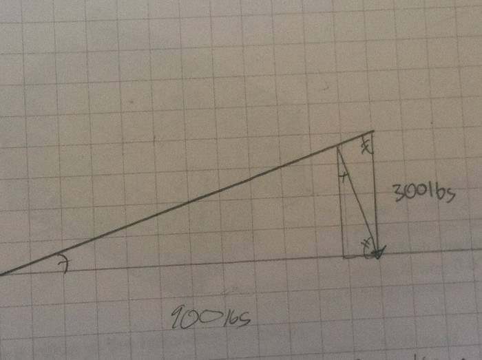

I read that the perpendicular component of the 300lb force can be figured out by 300lb*cos(inverseTan(4/12)) and the parallel component can be figured out by 300lb*sin(18.43*)
I do not understand why this is so. My attempt at the solution is to draw an FBD, but I suppose I am drawing the wrong one.
Hand-drawn diagram on grid paper of a sloped roof rafter line rising to the right, with a vertical 300 lbs load arrow pointing down at the right end and a dashed-free right angle; the load is resolved into two components labelled x and y, with the angle at the left marked by a symbol, and the label 900 lbs written below.
A free body diagram is nice, but what you really want to do is draw a triangle where the hypotenuse has a slope of 4:12 and then work out the angles normal and tangential to this slope. It's more a matter of geometry (and trigonometry) than anything else.
