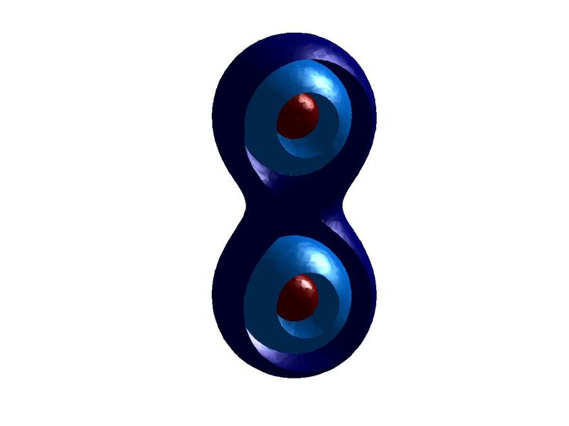

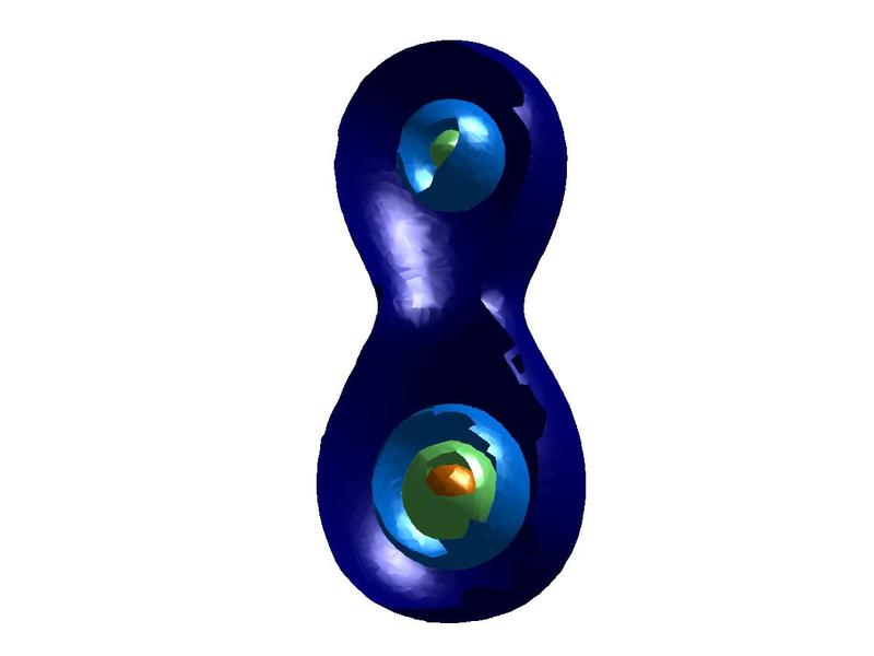

If you want to plot the [tex]H_2[/tex] molecule at T=0K, you could use the approximate 1s solution:
[tex]\Psi(\vec{r})=c_1e^{-\sqrt{x^2+y^2+(z-a)^2}/a_B}+c_2e^{-\sqrt{x^2+y^2+(z+a)^2}/a_B}[/tex]
where for example the symmetric solution is [tex]c_1=c_2=1[/tex]. Next let aB=1 and play with the distance between the nucleus =2*a in "units" of aB (Bohr-radii). Note: [tex]x^2+y^2=\rho^2[/tex], so you could plot a 2D-plot of [tex]\Psi(\rho,z)[/tex].
The 2-electron wave function: [tex]\Psi(\vec{r}_1,\vec{r}_2)=\Psi_{c_1,c_2}(\vec{r}_1)\Psi_{d_1,d_2}(\vec{r}_2)\pm \Psi_{c_1,c_2}(\vec{r}_2)\Psi_{d_1,d_2}(\vec{r}_1)[/tex]
When you integrate out one electronic coordinate from [tex]\Psi(\vec{r}_1,\vec{r}_2)^2[/tex], to get the charge-density, you get more or less the upper expression again.
Per
That's what I was looking for, thank you sundqvist (is this a central European surname?)
Actually it's even better, it's probability density functions, right? Cause wave functions typically involve spirally rotating complex vectors. But then why do you say that integrating these equations gives the charge density? Did you mean the percentage of charge in a given space?
A spheroidal shape was given earlier, as the orbital. That can't be right from what you've given. What I see in your 1s solution is the distance from each of two points (protons?) being taken as an exponential decay's length, and then you add the two decays together, the result can't be associated with a spheroidal orbital. I wonder if the 2-electron function you mention gives an orbital of that shape.
What are d1 and d2 in the 2-electron function?
I mean why are they assumed to possibly be different from c1, c2, isn't the molecule symmetrical?
And what does the +/- mean? It can switch between two states? Two types of hydrogen molecule?
Hi, for the lowest total spin S=0, [tex]\uparrow\downarrow[/tex], the total charge density n is symmetric. Let's scale x,y,z with aB, then the charge density is given by:
[tex]n=\Big[\exp(-\sqrt{\rho^2+(z-\frac{a}{2})})+\exp(-\sqrt{\rho^2+(z+\frac{a}{2})})\Big]^{2}[/tex]
where a is the distance between the nucleus. If you apply a strong magnetic field, the electrons will be spin-polarized, so that the total spin will be S=(1/2+1/2)=1, [tex]\uparrow\uparrow[/tex]. In that case you would have a overlap and mixing term (overlap=integral of the two exponentials) in the charge density. The distance "a" has to be optimized in order to minimize the total energy, but you could play with it when you plot it. Also note that n is unnormalized, but it does not matter when you plot it.
By the way I'm from northern Europe.
Per
I think what you've done here is to bring two ordinary hydrogen atoms together
and just written the equation of the overlapping wave functions. In fact, the wave
functions have to become distorted by the mutual proximity of the two atoms. I don't
see this in your solution. So I don't think it shows how the interaction leads to
a bonding force.
