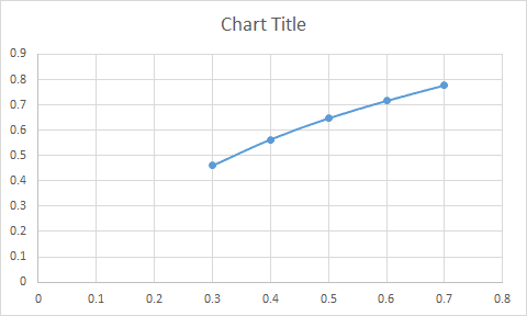

I would like to ask one more question. Does this consider to be a linear relationship ? It doesn't look very linear to me?
Can you label the axes? Or say what they are?
Does your simulation use real voltages for the diode and transistor switch? What about reverse recovery time of the diode, and the frequency characteristics of the transistor?
If you write the equation for the current thru the inductor at the end of the "ON" cycle, and the equation at the end of the "OFF" cycle, and realizing that the currenmt at the end of the "OFF" cycle must equal the current at the beginning of the "ON" cycle, then you can easily show that the relationship is not linear in the duty cycle δ defined as δ = "ON" time / ("ON" time + "OFF" time).
This assumes that the output voltage is constant (large output capacitor, not too large a load). "ON" means the transistor is on. Also ideal transistor and diode characteristics.
You can also show that for small δ the relationship between the duty cycle and the output voltage is approximately linear.
