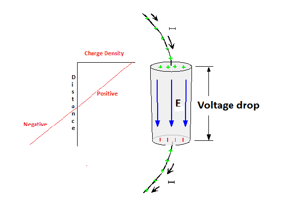

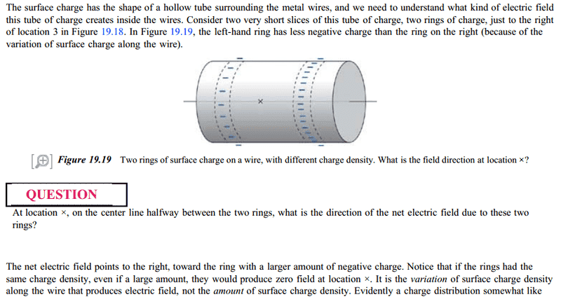

  • #31
UMath1 said:
See but then shouodn't voltage drop be uniform because it is only due to change in position.
Why would you expect that? Voltage drop is all about energy lost and there is very little energy lost as a charge flows through a copper wire so 'all' the volts are dropped across the load. Any model that you build in your head must take that sort of thing into account from the very start and it should ring the credibility bell before you move on to the next step.
  • #32
Voltage drop is about change in potential energy. Potential energy is a function of distance from field source(Kq1q2/r). Therefore, voltage drop must be uniform with respect to displacement towards field source.
Can you explain the PE graph here
https://community.dur.ac.uk/p.m.johnson/electric_circuits/11_bulb_circuit.htm
And can you explain why an electric field cannot act in a open circuit?

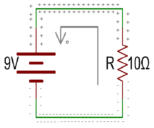

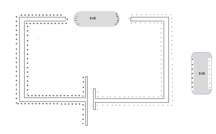

  • #33
UMath1 said:
I also don't understand why the circuit must be closed for the field to be set up. My textbook says that the electrons do not rush to the lightbulb as soon as the circuit is closed, but instead the field acts on the electrons near the lightbulb. But why can't the field act even if the circuit is open?
because the EM field isn't created till there is a charge/electron flow. And for a charge/electron flow to occur, there needs to be a closed circuit.
The EM field then travels along the outside of the wire at close to the speed of light

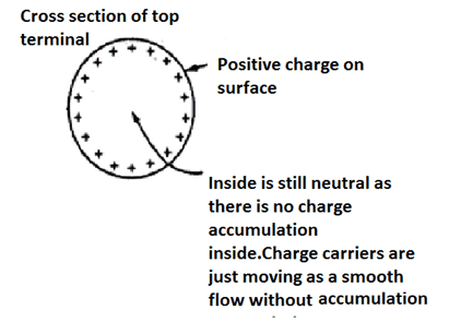

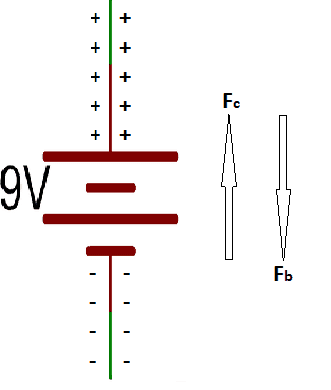

  • #34
Why is current needed for the electric field? Electric field is defined as kq1/r^2. If there is a source charge at the terminals can it not create a field acting on the electrons in the lightbulb? Or is that the force is weakened across air and the field is insignificant?

The issue I am having is that voltage is treated a total energy per unit charge but in electrostatics it was defined as POTENTIAL energy per unit charge. In a circuit, I understand across a wire with zero resistance there should be negligible energy loss. But shouldn't there still be a voltage drop. Wouldn't potential energy be converted to kinetic energy?
  • #37

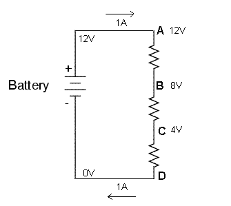

  • #43
Ohm’s law E=IR E= voltage I=amperage R= resistance
A simple circuit using 10 volts & 10 (1ohm) resistors
Battery Positive-----R1----R2----R3----R4----R5----R6----R7----R8----R9----R10----Battery Negative
At the Battery positive point in the system the voltage is 10V and the amperage of the circuit is I=E/R 10 volts divided by 10 ohms or 1 amp
The voltage at the point between R1 and R2 is calculated by removing R1 from the equation
E=IR E= 1 x 9 E=9
The voltage at the point between R2 and R3 is calculated by removing R1 & R2 from the equation
E=IR E= 1 x 8 E=8
Etc. Etc. Etc
Wire can thought of in the same manner as the resistors. The further down the wire the greater the resistance.
Now you have your voltage potential at different points.
and that's all from me do your home work.

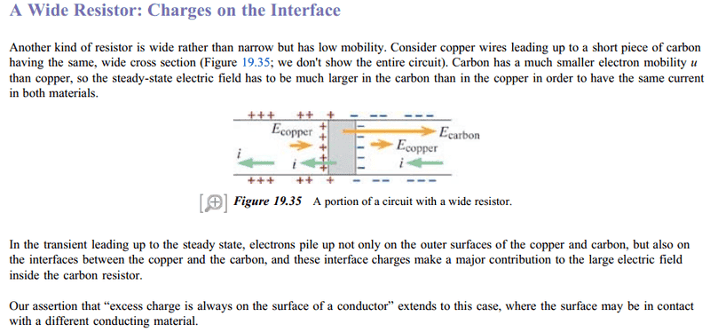

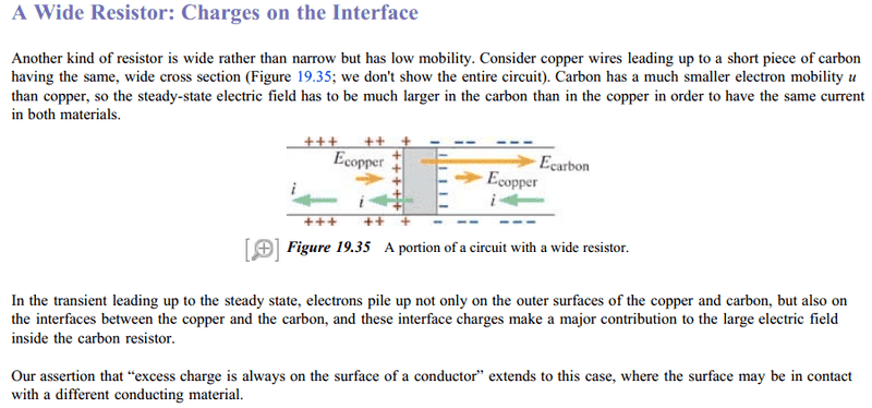

Jefimenko's scalar equation gives the relationship between charge density, ##\rho##, and voltage, ##\varphi##. For a point charge it reduces to the form you have been using.
The key mistake in your reasoning is that you are not taking into account the fact that ##\rho## is different in the two scenarios. Since ##\rho## is different, so is ##\varphi##.
  • #51
Sorry but I can't change it to basic level at this point and I am still confused. So if I understand correctly, to calculate the total electric potential you must sum the effects of each individual charge in the wire and this would be affected by the charge density. So the charge density in the resistor is different from that in the wire, and so the change in potential is different?
I don't see the clear connection between charge density and voltage though.

I don't think that you will be able to get un-confused yet. I think that you are asking a question that you are not yet ready to learn the answer. That is causing your confusion. In my opinion you need to take a step back and fill in some gaps first. We can answer your questions, and have already done so, but understanding requires asking the right questions too.

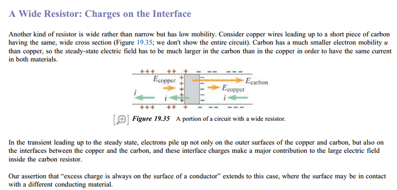

Yes, to calculate the potential from first principles requires knowing the exact charge density throughout the circuit. Alternatively you can just use Kirchoff's voltage and current laws. You get the same answer with a lot less effort.
Yes. The charge density in the entire circuit is different with vs without the resistor.

If you can explain the potential energy graph on this page :
https://community.dur.ac.uk/p.m.johnson/electric_circuits/11_bulb_circuit.htm that would be very helpful.
There are two questions here. I will address the first one first. Each resistor in your circuit is the equivalent of several miles of a conducting wire. You can easily calculate how long a wire you will need to replace a 1 ohm resistor. If you did that, you will see that the potential drop is indeed uniform across that very long wire. You are effectively taking a very very long wire, packaging it into a tiny wound bundle, and calling it a resistor. This is a model. Real resistors are made differently, but the model is pretty good.
Now the second one:
If you don't close the circuit, the electron no longer has a low resistance path to go through. The air gap has a very high resistance. If you increase the potential difference to very high values, you can even cause a breakdown through the air gap.
