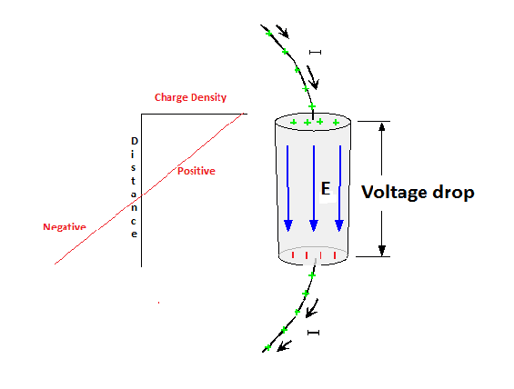

Now let us look into what happens inside finite resistance(say 10 ohms) as given in the diagram.1) Since there is an opposition to the flow of charges in a resistor there will be an higher density of electrons in the lower part of the resistor and the upper part is deprived of electrons.This is due to charge accumulation resulting from the opposition to smooth flow of electrons.Or in other words there is a charge density gradient both on surface and inside the resistor. This makes lower end of the resistor negatively charged(more electrons) and upper end positively charged.Charge density progressively changes from negative to zero and then increases from zero to positive value as we observe from lower end of the resistance to upper end
There will be an electric field inside the resistor due to this charge density difference, as shown as E in the figure.This electric field helps the charges to overcome the resistance and move across the resistor.The work done against resistance will be generated as heat.The potential difference due to this electric field is known as voltage dropAs you can see, the battery does a work against the electric field created due to separation of charges.While in a resistor, electric field does the work against the resistance.The potential energy given to the electrons , by the battery is creating the charge density variation/electric field in the resistance.And the energy is ‘dropped’ by working against resistance.Voltage created by battery is the work done/unit charge against the electric field and voltage drop is the work done per unit charge by electric field against resistance

So is the charge density in the wire before the resistor constant? And how is it possible for there to be a density gradient when the current must be constant? Do the electrons in the upper part have a higher velocity? If so why is that?

No, the charge density is higher on and near the surface of the wire compared to inside the wire. Also, if the wire has some resistance the surface charge density varies along the length of the wire.
The continuity equation is ##\frac{\partial}{\partial t} \rho + \nabla \cdot j =0##. There can be a density gradient, ##\nabla \rho \ne 0##, and a constant current, ##\frac{\partial}{\partial t} j = 0## without violating the continuity equation.

I have attached the figure provided in the textbook, "Matter and Interactions"
Figure shows the interface between a copper conductor and a carbon resistor during transient.Electron flow is from right hand side to left hand side, given as green arrows.In the initial transient, before steady state is achieved, the electrons tend to pile up in the interface between highly conductive copper and carbon with higher resistance.Hence if you consider the carbon resistor during transient, there is an inward charge flow to the resistor (electron flow from copper to the right hand side interface ) which is greater than outward flow from the resistor (flow from left hand side of the carbon resistor to copper , as shown in figure).Hence the right hand side become more negative compared to left side of the resistor.In the steady state, however the excess charges will be only on surface, but progressively changing from negative to positive as we observe from right side to left side.This is, if there is only one resistor in the circuit across the battery.If more resistors are there ,the surface charge density variation is from more negative to less negative(or less positive to more positive) depending on the circuit arrangement.In any case, this establishes an electric field from left to right inside the resistor(shown as Ecarbon), which helps electrons to move from right to left overcoming the resistance
Now coming to your question, if the copper wires are super conductors, then the surface charge density is constant on the wires.Because the required electric field to maintain current flow is zero if there is no resistance.It is the variation in surface charge that produces electric field.In practical conductors, there will be progressive variation in the surface charge density which establishes the required electric field to overcome wire resistance.This surface charge is created during initial transient when the switch is closed and the steady state will reach in nano seconds.One more screenshot from "matter and Interactions" is attached for your reference.
In steady state, the force due to this electric field, exactly cancels the resistance offered by conductor/resistor(Similar to a force applied against friction when an object is moved at constant velocity).This makes the charges to move at a constant drift velocity, and hence constant current.
