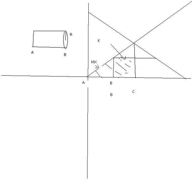

Hi,
Use two fonctions y=mx for a to b and y=k for b to c
add the result and multiply by two.

Thanks All, But how to we actually get from A=πy2 δx to ∫πf(x)2dx
How does the area become the volume?
A is the area of a circle with radius y & y = f(x). That radius goes from the x-axis, vertically up to the graph y = f(x). Multiplying times δx (delta-x) gives the volume of a very thin circular disk of thickness δx . The integral from x=a to x=b indicates that the volume of a series of such disk is summed to give the total volume of the solid of revolution.
The definition of an integral is adding (\sum) very skinny things (lim\delta x-->0) between two points.
If you are finding the area under a curve, you integrate between two points and are adding skinny rectangles (with almost no width i.e\deltax), which are practically adding lines. (you just add the heights \intydx)
With volumes, in this case, you are adding skinny cylinders, until the cylinder becomes practically a circle. (you just add the areas of those circles \int\piy2dx)
Adding lines gives an area
Adding areas gives a volume (just imagine adding all the areas of the pages of a book to get its volume)
