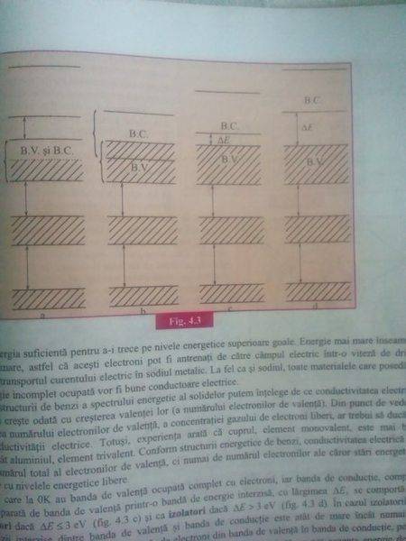

I have another question.
Consider the figure from the image.
In the book it says:
" Solids are conductors in the following two cases:
a) the band with the highest allowed energy, called valence band (BV), is not fully occupied with electrons (see figure 4.3.a). In this case, the valence band is the same as the conduction band.
b) the valence band overlaps with the next band, completely empty, called conduction band (see figure 4.3.b)"
So, in case a) I can see what happens. For example, sodium described by 1s2 2s2 2p6 3s1. We will have 3 fully occupied bands followed by a band occupied only half of it. So, even an weak electric field applied to the crystal can excite the electrons in the other half of the band. So sodium is conductive.
But I don't understand the case b). How can it overlap?
I think they make a distinction between metals and semimetals but don't say this specifically.
And the overlapping refers to phonons, momentum and such.

About overlapping, you can think what happens as you bring the atoms closer and closer. Every atomic energy level splits into closely spaced levels, which form the bands.
If the widths of two neighboring bands becomes larger (in energy) than the distance between initial levels they will overlap.
See this diagram, for example:
http://ecee.colorado.edu/~bart/book/book/chapter2/gif/fig2_3_2.gif
