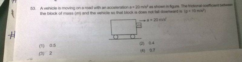

What is the Frictional Coefficient for this Homework Statement?
  • Thread starter Thread starter Priyadarshini
    Coefficient
13 replies · 2K views
Priyadarshini
191
a=meu*g
meu= 20/10
= 2
The answer's wrong

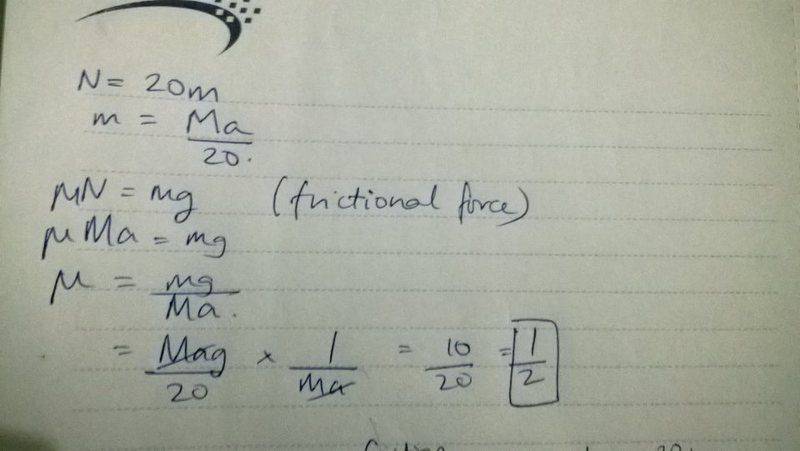

The firctional force is meu*normal force, so the frictional force is meu*M*a
Can I do this:
The driving force- frictional force = (M1+M2) a
friction= [F-(M1+M2)a]
so meu = [F-(M1+M2)a]/M1a
meu= [M1a - (M1+M2)a]/M1a
meu = M2/M1
But then what?

What is the acceleration of the smaller block?
Isn't the acceleration 20m/s^2 for both the blocks?

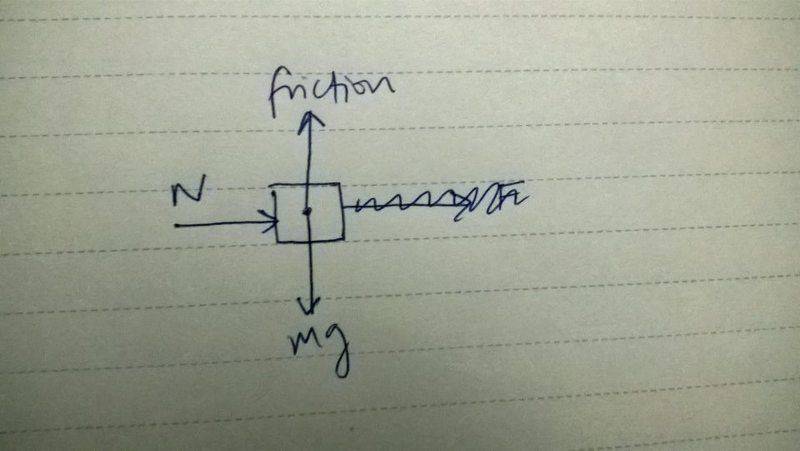

Yes. That is what is needed. Write the equation for forces "on" the smaller block. You'll get the value of friction coeff just to avoid slipping. You'll see Chestermiller's reply makes true sense!
Have you drawn a free body diagram showing the forces acting on the smaller mass, or do you feel like you have advanced to the point where you no longer need to use free body diagrams?
Chestermiller said:
Have you drawn a free body diagram showing the forces acting on the smaller mass, or do you feel like you have advanced to the point where you no longer need to use free body diagrams?[/QUOTE ]
Got it! Thank you!
