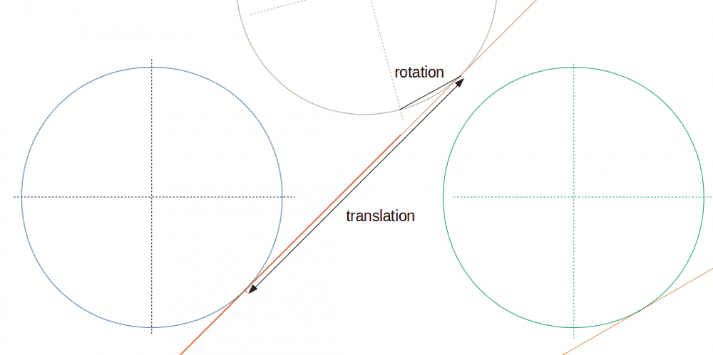

  • #151
JrK said:
You spoke about what image ? the image of the message # 147 is the second case: no translating, rotating.
Your scenario is case 3: translating and rotating relative to the wall. The other cases were just a decomposition of case 3 into the two components.
Draw your scenario, in the rest frame of the wall, just as I explained:
- Draw both time-points in your original frame
- Rotate each time-point-image around the wall-pivot, such that the walls align (and ideally are horizontal)

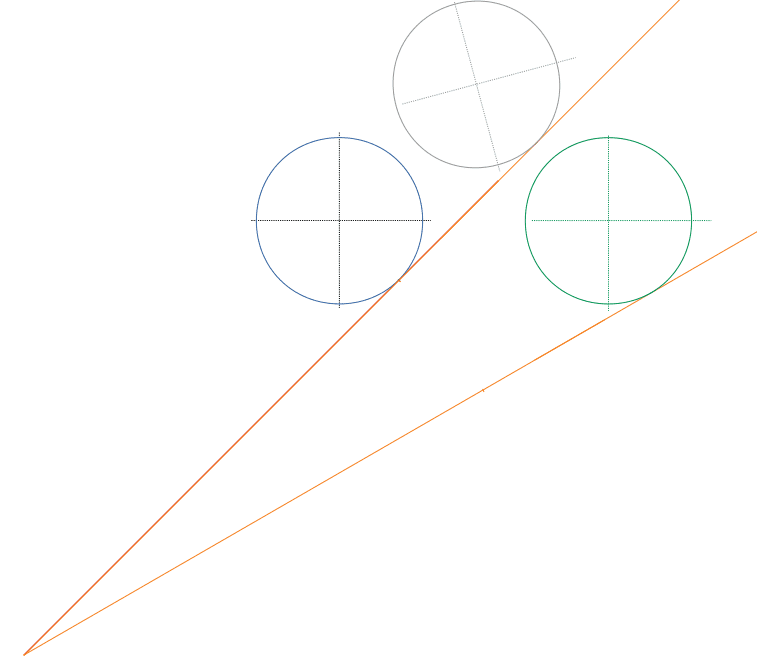

  • #152
I'm not sure to understand, is it the case 2 ? :
We are agree that the wall at 45° is fixed (not the 30°) ?
  • #153
I thought that case 2 was rotating, not translating. In #152 you show three circles. Are we to understand that GRAY is the before, GREEN is the after and BLUE is irrelevant? If so, that's neither rotating nor translating. That's glued-to-the-wall.
  • #154
You speak at me ? For me, blue is the start, green the end and gray is the modification asked by AT. In fact, I don't understand what I drew :p but I try. The wall fixed is at 45° not 30°. It is very strange that I drew. I need help. In fact, what I do with these drawing ?
  • #155
If you do not understand what you drew, how do you expect us to?
If you are trying to depict rotation without translation then depicting translation is not appropriate.
If you are trying to depict rotation with translation then the BLUE transitioning to GRAY is correct in everything except, possibly, scale and the GREEN is irrelevant.
It would help if you put enough commentary with your drawings that we know what you are trying to depict. Extraneous circles and extraneous walls are not helping.

JrK said:
But you confirm the #152 is the case 2/
No, #152 is your scenario, which is case 3: Relative to the wall the circle is translating and rotating (compare blue and grey circle).

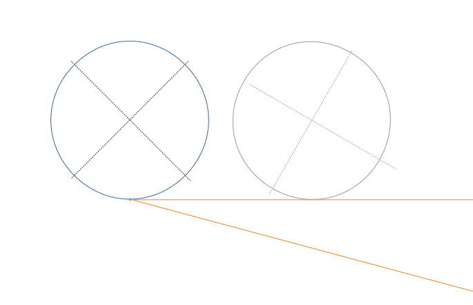

  • #165
A.T. said:
Make the cross-marking initially go through the contact point.
I don't understand.
I place the circles horizontal and after ? It is A0 on the dot of contact ? :
Or maybe it is :
I see the mark on the left circle and on the right circle. The length of the friction is that distance ?

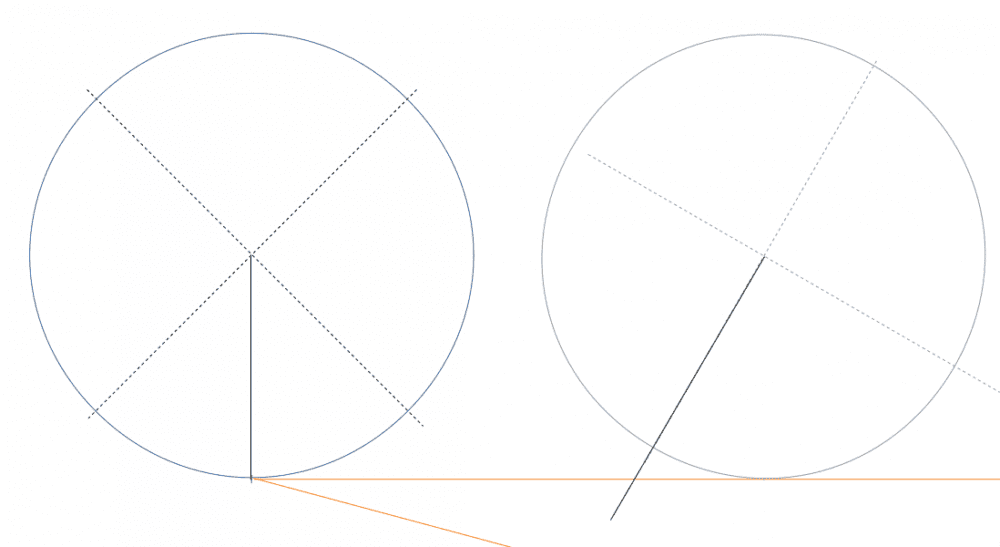

  • #166
JrK said:
I don't understand.
Good, now adjust the dotted-markings such that initially one of dotted lines hits the contact point. For the final state they are rotated counter-clockwise from the initial state.
Then mark in different colors:
- the part of the wall that was in contact with the circle
- the part of the circle that was in contact with the wall

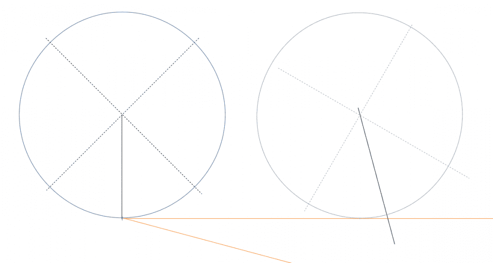

  • #167
You want I rotate the circles ? only one ? in which direction CW CCW ?
  • #168
Both by the same amount, so the initial contact point is marked on the circle. And use only one radius line for that, not 4 of the same color making it ambiguous,
  • #169
But the initial marks on the two circles are already in contact with the wall. Which amount to rotate ? CW or CCW ?
  • #170
I mean the oblique dotted lines through the center of the circle. The are useless.
For the initial state draw a single radius to the initial contact. Then for the final state the same marking rotated with the circle CCW.
  • #171
I drew that:
It is correct ?
  • #172
JrK said:
I drew that:
It is correct ?
No. The new solid line mark cannot rotate relative to the old dotted line marks. They are all just marks on the same circle. They have to rotate with the circle in the same way.
Is this not obvious to you?

  • #174
JrK said:
I don't understand what I'm doing
You have added a new mark on the blue circle, right in the middle between two old dotted marks.
For the grey circle that new mark must also be right in the middle between two old dotted marks.
  • #175
like that ?
  • #176

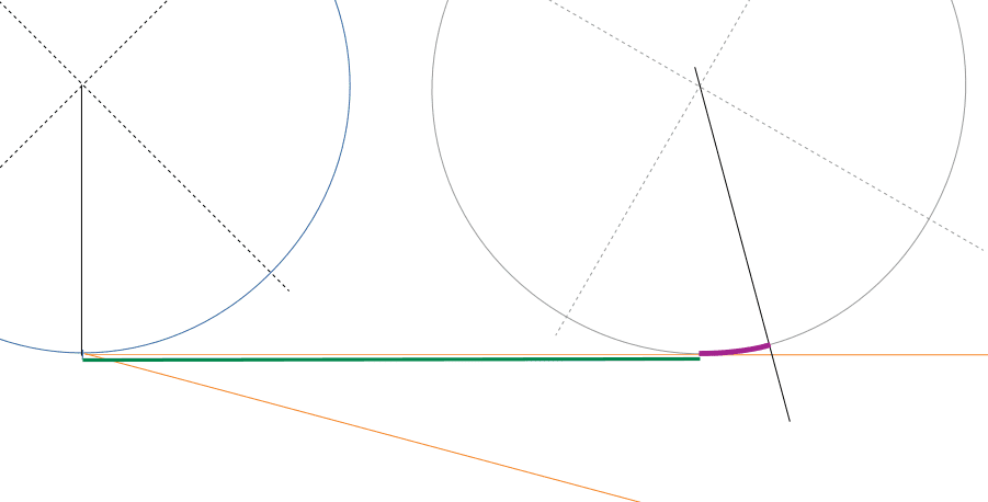

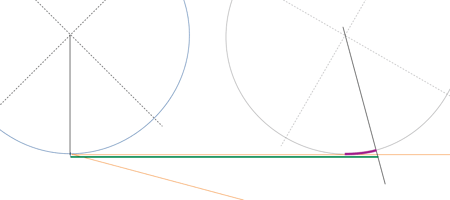

  • #177
green: wall in contact with the circle
violet: circle in contact with the wall
  • #178
JrK said:
View attachment 261975green: wall in contact with the circle
Why does green go beyond the final contact point?
  • #179
so like that:
  • #180
JrK said:
so like that:
Yes.
The total slip distance is the sum of the green and violet length. This is the distance that you put into F * d to compute the energy dissipated by friction.
