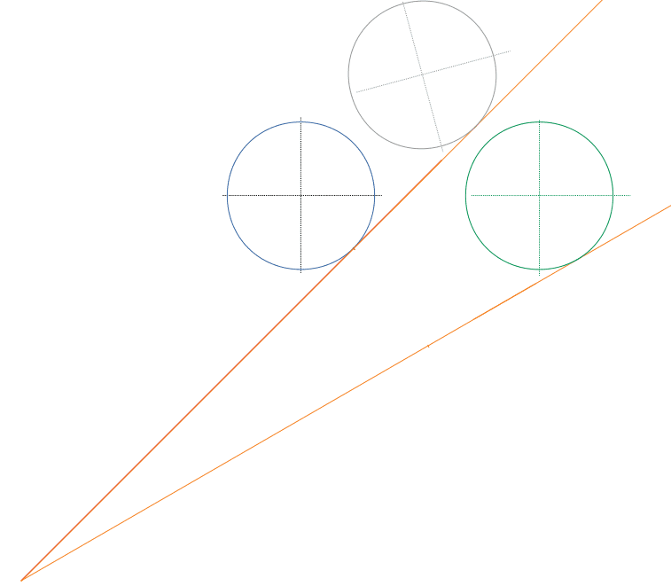

And I measured d1. Again, you forgot something very important: the position of the dot of contact from start to end: from a fixed dot on the circle for example. It is easy to watch the problem: take a circle fixed on the ground. Rotate a wall around the circle without any sliping (there is friction but there is no heating), you can see a distance moved by the distance measured but like the dot of contact moved the same distance: there is no slip, so no heating. Here, I took at start d2 because it is logic for me, but with the construction you will have d1 but you need to take in account the distance moved by the dot of contact (in reference to a fixed dot on a part of the device) and at final I have : d1-(d1-d2).
Note, it doesn't resolve my problem with the needle and the elastic. I don't find the mistake in that different example.

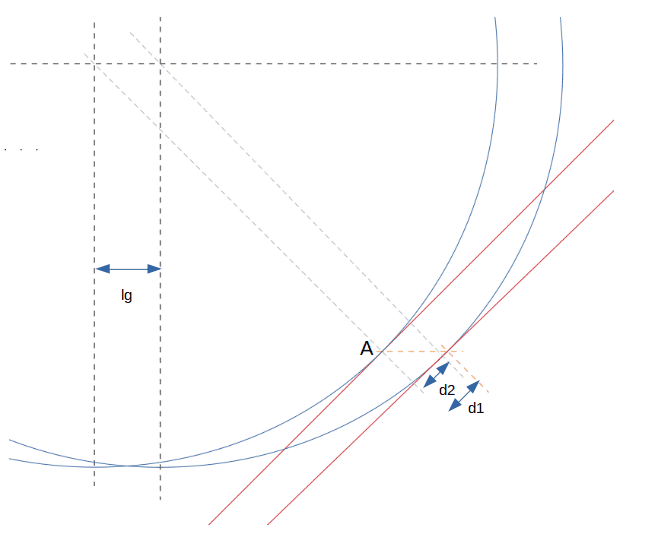

For me when you asked me to build the case 3/ I rotate the circle of the same angle than the wall rotate around A0 but it is not true ! the circle in the reference of the wall rotates only of a smaller angle. Look at the drawings, the circle rotates only of the angle that will give d2 not d1. So, like it doesn't help me to understand why I see a lack of friction in the movement. And like I drew the example with the needle + elastic to help me. Could you help me to find the mistake inside the example with the needle + elastic please ? Here I don't need any transformation so the mistake could be at the angle.
I rewrite the example:
The circle moves in horizontal translation, the circle doesn't rotate around itself, the red wall rotates around A0, and A0 is fixed to the ground. The circle is always at contact with the red wall. The mass is very low and there is no friction. There is no acceleration/deceleration. The bodies are rigids except the elastic. The force of the elastic is contant : F. I drew the start and the final position, the circle and the red wall are controlled in position with a cylinder and a motor for example, I count the energy I need to give to push the circle and I count the energy stored inside the elastic, I also compute the energy from the force F3 and F4 on the lateral walls. There are 4 objects: the circle and the wall, the elastic and the needle. The needle has a diameter very small: some atoms, to be near the dot of contact, I cannot be at the dot of contact but from start to end with a very small diameter for the needle, the distance from the dot of contact will not change to reach the distance d1 in the calculation of the energy stored inside the elastic. The sum of forces on the needle is 0: the elastic pulls it but the lateral walls prevent it to move closer to the dot B. Please, look the enlargements to watch the needle more farther.
The example:
The example from start to end:
Enlargement of the previous image:
Enlargement of the area where there is the elastic, I drew the start and final position, the elastic is taken by the dots A and B, the dot B is fixed on the red wall, the dot A is fixed on the needle, the needle is near the dot of contact between the circle and the red wall:
To watch the forces of the elastic F1 and F2, I drew the start and final position, at start the elastic has a length at 0, and at final its length is d2:
To watch the needle (the needle is perpendicularly to the screen and its diameter is very small), I drew only the final position, the needle is pulled by the elastic but the lateral walls prevent it to move closer the dot B:
Enlargement, I drew the final position, to watch the forces from the needle to the lateral walls (circle and red wall):

The results:
The energy to move the circle: lg*cos(44.5°)*F = d1*F (in the computation I calculate the integral)
The difference of energy stored inside the elastic: d2*F
The energy needed from F3 is equal to the energy recovered from F4
d1 is different of d2

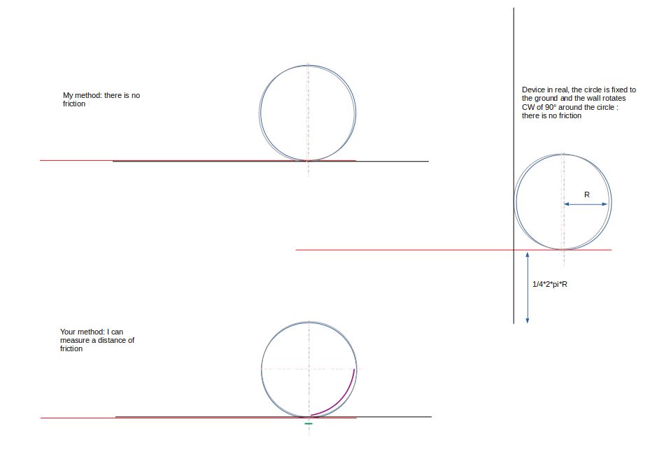

  • #184
JrK said:
For me when you asked me to build the case 3/ I rotate the circle of the same angle than the wall rotate around A0 but it is not true.
That's just a coordinate transformation to the rest frame of the wall. In such a coordinate transformation you have to rotate everything in the same manner.
  • #185
I drew, with your method, the rotation of a wall around a fixed circle without slipping but with friction. The energy from the friction is 0. The energy to rotate the wall around the circle is 0 (I supposed no acceleration, no decceleration and no mass). It is logic, no energy from friction, no energy to rotate the wall. But with your method I have the energy from friction at L*F with L the length of the friction your method sees. Because your method forget to take in account the movement of dot of contact relatively to a fixed dot on the circle. Something is wrong with your method, for me it is the dot of contact that it didn't take in account. The rotation of the circle I drew in the case 3/ relatively to the wall exists if the dot of contact is as far as the full rotation, the dot of contact is the dot where there is the force of friction. Anyway, if your method works, it must work for a basic rotation of a wall around a fixed circle, it is not the case.
  • #186
No, my method gives 0 slip distance for pure rolling, if you apply it correctly. Please read the instructions I gave for the two elastics (which are just proxies for the green and violet contact areas you drew in post #179):

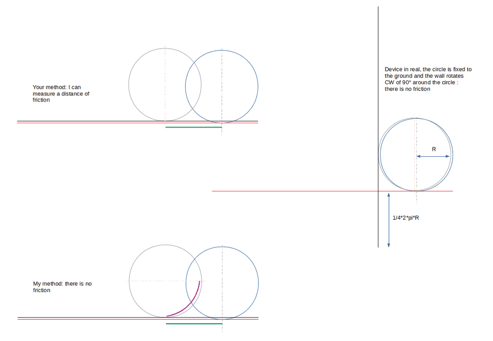

The method:
1/ I take the dot of contact fixed
2/ I measure the distance from the dot of contact from start to end of the first object, it is the path of the dot of contact on the first object
3/ I measure the distance from the dot of contact from start to end of the second object, it is the path of the dot of contact on the second object
4/ The algebraic sum is the distance of friction
The distance 'da' is the distance of the path of the dot of contact, it is a lack of distance of friction because the direction is the direction of the wall but in the same time the wall rotates CW (because the dot rotates CCW but the dot is fixed) and that distance is 'db' the direction is an augmentation of the distance of friction, so I need to add 'db'. With the absolute value of 'da' is equal to the absolute value of 'db', so da+db=0. The distance I have at final is the distance from the dot of contact with the wall and it is d2.

  • #191
The method you explained works only for some examples not all. I would like a general method. I used the method of the dot of contact fixed on the ground but like I need to transform the geometry I would like to have a direct method. I find this one, easier, and it is possible to think directly with the drawing.
I fixed a dot C on the end of the red arm, I measure the distance from the dot of contact i1 to C and I reported that distance from the dot of contact i2 (red dotted line), I can measure the distance the red arm slipped WITH the rolling: d3. And d3=9.3, I need to add the distance 'db' because the circle rotates CCW relatively to the red arm, the sum is 9.3+1.05=10.35 but I need to subtract the distance the of rolling 1.05 the sum is 9.3 it is d2 (d1 corrected with the integral of the cosine angle is 10.28).
Why I subtracted the rolling: think with a circle fixed on the ground, rotate the wall around the circle of one turn without any slipping: the distance d3 is equal to the perimeter of the circle: there is no distance of friction. Here, without any slipping of friction, d3 would be at 1.05 (the angle is 15°, the radius at 4). If I measured d3=1.05, there is no energy from friction. If I measure 'x' I need to subtract the 1.05 to 'x'.
  • #192
It works fine for your original scenario (see post #179). Which other scenario do you want to analyze where it fails? Show me how you applied it.

  • #195
A.T. said:
So for which other scenario do you want to analyze where my method fails?
This one for example:
When I drew your method, I take the wall and the circle at the final position and I rotate all the group to compare with the start position, but the circle doesn't rotate in reality so I need to replace it like I drew for your method. If I rotate the circle, all is fine, but in that case I need to do the same job in my drawing because here like in my example the circle doesn't rotate :
And I measure d2. I'm agree, friction depends of the relative motion but I think you forgot the rotation of the wall around the circle. My method I drew is the method I used in #133.
In the example I drew here, you could apply too the method with the dot fixed on one end of the red wall: the dot C. It is easier to think with the drawing fixed.
  • #196
- There are no markings on the wall, to see how it moves. Is there slippage or pure rolling?
- The contact areas are missing (the green and violet lines in post #179)

  • #198
JrK said:
It is a pure rolling.
Then top left is not "my method", but a completely different scenario (pure sliding). Bottom left looks OK, so let's apply my method:

No, this is nonsense again. The correct image for pure rolling is bottom left in the old version:

Yeah ! you're right ! Thanks a lot :) I understood my mistake I saw a rolling where there was not. And your method works with a rolling and a slipping, I tested. Just for fun, could you help me in the same example with the needle I resumed at the message #183 ? it is the same but I replace the friction by an elastic attached between the needle and the red wall. It is more a problem of calculation here because the needle is at the position of the dot of contact. Even the lateral forces are high (with a needle of 1 atom, the lateral forces F3 and F4 are around 70000 higher than the force of the elastic).
  • #204
What you have in your original scenario is the opposite of rolling: Relative to the wall the rotation of the circle is in opposite direction to roll rotation. And that increases the slip distance.
You can capture all cases with this formula (rest frame of the wall, wall is horizontal, with the circle above it):
slip_distance = | right_circle_translation - CW_circle_rotation * circle_radius |
In your scenario CW_circle_rotation is negative (because the rotation is CCW), so that subtraction makes the slip_distance greater.

What you have in your original scenario is the opposite of rolling: Relative to the wall the rotation of the circle is in opposite direction to rolling. And that increases the slip distance.
slip_distance = | right_translation_along_wall - CW_circle_rotation_angle * circle_radius |
In your scenario CW_circle_rotation_angle is negative (because the rotation is CCW), so that subtraction makes the slip_distance greater.
Yeah, I understood your method, I tried it and ok it works on the drawings for not composed examples. But I see the rolling when I move the objects in reality with my example. And even when I used the dot 'c' fixed on one end of the red arm I see the distance like d2 not d1. And when I use the method of the dot of contact fixed on the ground I have d2 not d1. Very odd.

  • #206
When both objects are moving, it's much harder to deduce the relative motion accurately. That's why you should transform into the rest frame of one of the objects.

Yes, very difficult !
I drew for a small angle of rotation, I drew at left the start and ending position. The circle moves in horizontal translation and the red wall rotate around A0. I drew at right your method:
An enlargement:
How I measure the distance of friction ? There is no "green" distance but there is an angle for the circle.
Why? To make it even more difficult? Draw a bigger difference, if you want to work graphically.
BTW: If you don't want to transform the entire image to the rest frame of the wall, just transform the initial contact point twice, for each body separately to their final locations. Then in the final image, for each body draw the contact areas, from the transformed initial contact to the final contact.

Ok, all is fine, I understood my mistake in the drawing and a mistake in the integral. So even with a small angle the friction is well equal to d1. Great !
  • #210
What do mean by "even with a small angle"? I think you have the logic of checking geometric formulas backwards: If a formula works for larger angles, then it definitely also works for small / infinitesimal angles. It's the other way around, where you have to be careful, because small angle approximation can fail for larger angles.
That's why your images with tiny displacements are so useless: It hard to see anything, easy to make errors, and even if you get it right you cannot automatically generalize it.
