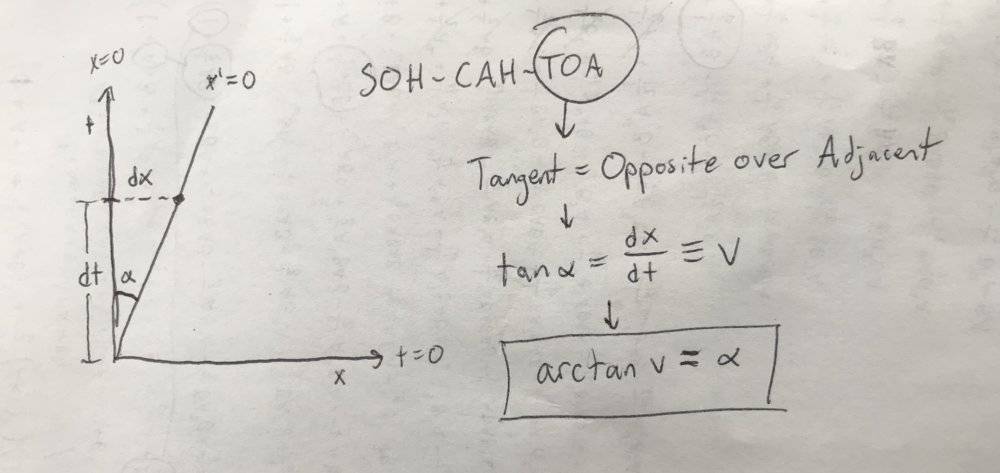

according to this wikipedia page says that angle between coordinalines(and basevectors) in different frames of reference is atan(v/c), but I tried to derive it and got that these angles are ##arcsin(v/c)## and ##\frac{2\pi}{4}-arccos(v/c)##. Derivation is on the picture that on the link. Where is the mistake in my derivation? ##v_t## is speed between the frsmes of references.
##\frac{\partial x´}{\partial t}=v_t## because an object that is in rest in one frame of refence must move with speed ##v_t## in another frame of reference.
Also would that in 1. frame of reference c*t and x are crosswise but not in another frame of reference(x') make first one preferred or different?

I think you’re making it way more complicated than it is. On a Minkowsi diagram, the worldline of a particle (##x’=0##) moving with speed ##v \equiv \frac{dx}{dt}## makes an angle ##\alpha## with the ##t## axis (##x=0##). The fact that ##\tan{\alpha} = \frac{dx}{dt}## should be obvious, so clearly, the inverse tangent function of ##v## gives ##\alpha##. Pretty much the same argument can be used to get the same angle between ##t’=0## and ##t=0##.
I’m assuming by “crosswise” you mean orthogonal, in which case the ##t’## and ##x’## basis vectors are orthogonal (using the Minkowski metric).

How exactly are you defining the term ##\alpha_{t-t’}##? I think you may be inventing notation that is causing you to confuse yourself. In the Wikipedia article, ##\alpha## is simply the trigonometric angle between the corresponding basis vectors of two frames moving with speed ##v## relative to each other.
Also, there is no need to bring in the Lorentz transformation to understand why ##\alpha = \arctan{v}##. Please describe what issues you are having in understanding what I’ve said in post #3 and #13.

Okay, for the third time, you are making this way more complicated than it really is. Look at post #3. Look at the picture in post #13 if you need to. Tell me what exactly you’re having trouble understanding. Or explain to me why you think it’s necessary to use components of the Lorentz transformation to find the relation between ##\alpha## and ##v##. Or re-read what @vanhees71 said in post #14, and stop worrying about trigonometric angles on a Minkowski diagram, since they have little to no use in learning SR.

Euclidean geometry is not useful on a Minkowsi diagram. But ultimately, the diagram is drawn on a piece of paper, and paper lends itself particularly well to Euclidean geometry since it’s a good approximation to a two dimensional Euclidean space. This fact is incidental and does not mean that Minkowsi diagrams should be interpreted using Euclidean geometry.

The angle you are referring to has nothing to do with ##dx' / dt## or ##dx / dt'##. It's just ##\text{atan} (dx / dt)## in the "stationary" frame for an object that is at rest in the "moving" frame. Just as @Pencilvester has been telling you.

Since these are cartesian coordinates, the angle between the x and t axes is ##\pi /2## by definition. That means ##\alpha_{t'-x}## and ##\alpha_{t-x'}## are just the complementary angles to ##\alpha_{t'-t}## and ##\alpha_{x-x'}##: (##\pi/2-\alpha_{t'-t}##). If you want that in terms of ##v##, that’s the same as ##\arctan(1/v)##.
But again, I feel I must reiterate—these are simple trig problems in 2D Euclidean space that don’t have anything to do with learning SR.
olgerm said:
As I understood ##\alpha_{t'-t}=\alpha_{x-x'}=arctan(\frac{v}{c})##
If by this you mean the Euclidean angles between the ##t'## and ##t## axes, and between the ##x'## and ##x## axes, on a spacetime diagram where both sets of axes are drawn with the same origin, then yes, this is true. But, as has already been commented, this angle is not useful for actually learning SR or solving SR problems.
