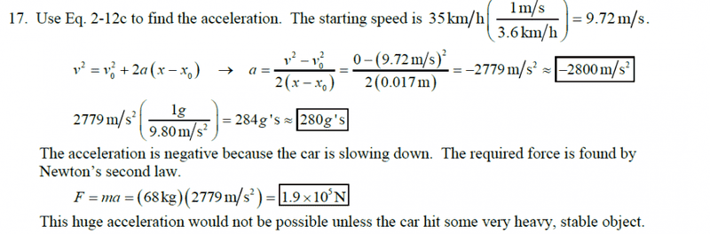

Calculate the acceleration of a 1400kg car if it can stop from 35km/h (9.72m/s) on a dime (diameter= 1.7cm) (0.017m). What is the force felt by the 68kg occupant of the car?
v^2=v0^2+2a(x-x0)
F=ma
ok after solving for a in that equation i get -2779m/s^2. when i go to calculate the force felt by the 68kg constituant, i'd just plug everything in, which would mean i'd get a negative force. the back of my book says that the answer is correct but instead of it being negative like i have it it is positive. WHY? why was the acceleration changed?
It's difficult to tell without having the book, but it's likely that it was simply looking for the magnitude of the force, which would be positive.
Textbook problem 17: Can cars stop on a dime? Calculate the acceleration of a 1400-kg car stopping from 35 km/h on a dime (diameter 1.7 cm), how many g's, and the force on a 68-kg occupant.
the books question
Worked solution for a car crash problem: 35 km/h converted to 9.72 m/s, acceleration a = (0 - (9.72 m/s)^2) / (2(0.017 m)) = -2779 m/s^2, about -2800 m/s^2, then 284 g's, about 280 g's, and force F = (68 kg)(2779 m/s^2) = 1.9 x 10^5 N.
the answer
Yes, it looks like they're just looking for the magnitude of the force.
