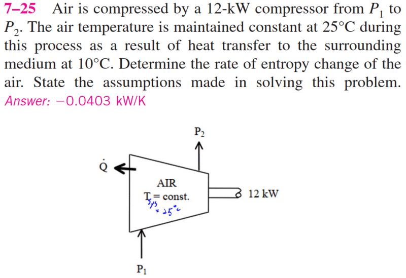

Why is the entropy value of this steady flow open system not equal to zero?
tracker890 Source h
90
To determine system entropy in a steady flow
entropy balance in a steady flow
Q: Why the entropy value of this steady flow open system is not equal to zero?
My idea is as represented by the following equation.
\frac{dS_{sys}}{dt}=0,\,\,\,\,dt\ne 0
\therefore dS_{sys}=0\,\,\,\,\,\,\,\,\therefore ∆Ssys=∆Sair=0
\therefore ∆\overset{\cdot}{S}sys=∆\overset{\cdot}{S}air=0
reference. 7-25answer
The system is the air. Just because the system is at steady state, that does not mean that the properties of the air exiting the compressor are the same as the properties of the air entering. Are you familiar with the open system (control volume) version of the 1st law of thermodynamics. If so, please write it down for this system operating at steady state.
Chestermiller said:
The system is the air. Just because the system is at steady state, that does not mean that the properties of the air exiting the compressor are the same as the properties of the air exiting. Are you familiar with the open system (control volume) version of the 1st law of thermodynamics. If so, please write it down for this system operating at steady state.
My thoughts are as follows, but I'm not sure if they are correct.
∆\overset{\cdot}{S}sys=\frac{dS_{sys}}{dt}=\left( \overset{.}{S}_{in}-\overset{.}{S}_{out} \right) +\overset{.}{S}_{gen}=\left( \sum{\frac{\overset{.}{Q}_{in\ sys}}{T_{sys}}}+\sum{\overset{.}{S}_{mass,input}-}\sum{\overset{.}{S}_{mass,output}} \right) +\overset{.}{S}_{gen}
may\ be\ \sum{\frac{\overset{.}{Q}_{in\ sys}}{T_{sys}}}\ne 0,\sum{\overset{.}{S}_{mass,input}}\ne 0,\sum{\overset{.}{S}_{mass,output}}\ne 0,\overset{.}{S}_{gen}\ne 0,
but\ ∆\overset{\cdot}{S}sys=0\ in\ steady\ flow\ system

They are looking for ##\dot{S}_{out}-\dot{S}_{in}##
Apologies, I cannot understand the content of your reply. Could you please provide more details, thank you.
And I think the key is:
\frac{dS_{sys}}{dt}=0,\,\,\,\,dt\ne 0\ \ \therefore dS_{sys}=0\,\,\,\,\,\,
reference
reference
They are looking for $$\dot{S}_{out}-\dot{S}_{in}=\frac{\dot{Q}}{T_I}+\dot{\sigma}$$ where ##T_I## is the temperature at the interface between the system and surroundings. The term ##\frac{\dot{Q}}{T_{system}}## in your reference is incorrect.

"the system is at steady state..."
so the system is unsteady?
No. The system is steady. At any location in the system, all thermodynamic parameters are constant in time. But the parameters vary with location through the system.
So, the conclusion is as follows, correct?
∆\overset{\cdot}{S}sys=\frac{dS_{sys}}{dt}=\left( \overset{.}{S}_{in}-\overset{.}{S}_{out} \right) +\overset{.}{S}_{gen}=\left( \sum{\frac{\overset{.}{Q}_k}{T_k}}+\sum{\overset{.}{S}_{mass,input}-}\sum{\overset{.}{S}_{mass,output}} \right) +\overset{.}{S}_{gen}
may\ be\ \sum{\frac{\overset{.}{Q}_k}{T_k}}\ne or=0\ ,\sum{\overset{.}{S}_{mass,input}}\ne or=0,\sum{\overset{.}{S}_{mass,output}}\ne or=0,\overset{.}{S}_{gen}\ne or=0,$$
but in any case, when the system is a steady flow system, ##∆\overset{\cdot}{S}sys=0##.

No. The correct equation is:
\frac{dS_{sys}}{dt}= \sum{\frac{\overset{.}{Q}_k}{T_k}}+\sum{\overset{.}{S}_{mass,input}-}\sum{\overset{.}{S}_{mass,output}} +\overset{.}{S}_{gen}=0
