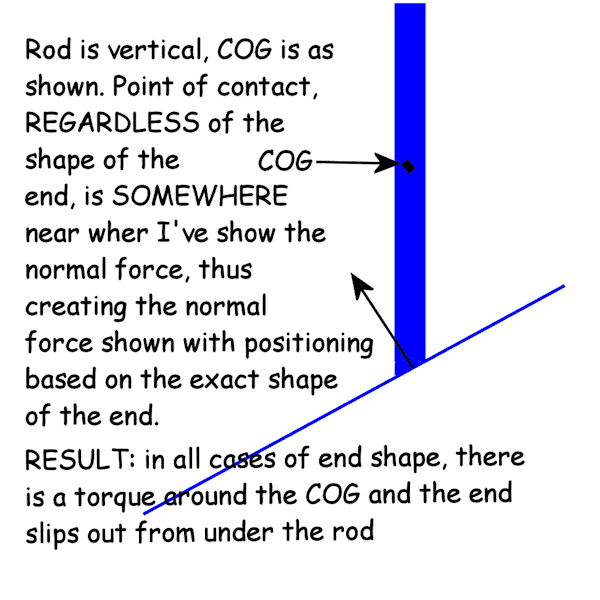

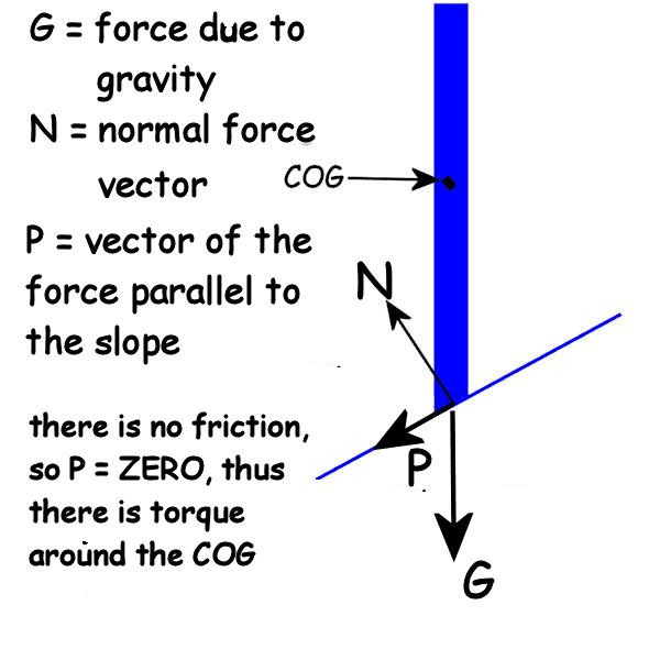

This is a graphic of my original analysis posted in #8 and #10. We've gone 'round this so much that I now can't tell who agrees w/ me and who doesn't and why.
SO ... if this is wrong, can someone explain to me WHY it is wrong and if it's right can we all just agree to stop going 'round and 'round?
I agree, but you are ignoring the special case of a rod perpendicular to the slope.

I don't care about that case, I'm only dealing w/ the vertical rod. In case anyone still has doubts, let me give the full vector analysis of the vertical rod, extending what I said in post #38
This is just the vertical special case of the more general solution that @Ibix presented in post #26

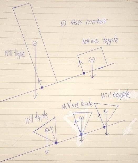

In my opinion you should care, at least me finds it very counterintuitive that the perpendicular to the slope rod will not topple
I do care. The vertical rod is a trivial and obvious case, it will topple.
The perpendicular rod is the core of the sphere, and follows the same physics as the sphere. A sphere will not roll, but will slide, a perpendicular rod will not topple.
The shape of the bottom of the object in contact with the sloped surface has a big impact. For example, as shown in the image below, A will obviously topple, while B will most likely not.

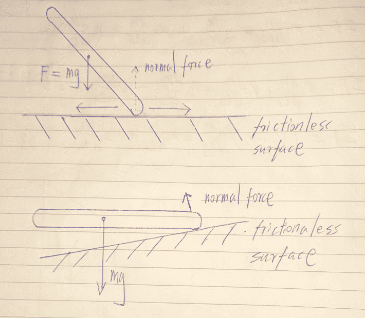

Which means that if the rod is placed like that:(figure below), the rod won't topple?
If the force that act on the rod is mg, the rod will topple right?, but if the force that act on the rod is mgsinx then it will make sense that the rod won't topple
Forces are vectors. The weight force has magnitude ##mg##, but the component parallel to the slope is ##mg\sin x##, assuming ##x## is the angle the slope makes with the horizontal.
Again; You can balance a pin on its point for a while, but it will eventually fall. Likewise, you can stand a rod on a horizontal surface, and it can be stable if it has a sufficiently flat end-profile.
But without friction, a rod would slide off the end of the ramp before it began to lean away from the perpendicular. In the short term, the shape of the rod-end in contact with the ramp is irrelevant, so long as a perpendicular to the ramp, that passes through the centre of gravity, also passes through the contact patch or point.

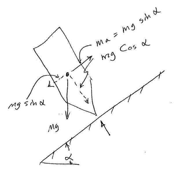

The diagram in Post #43 is not correct. Here is the free body diagram of a pointed rod perpendicular to a sloped frictionless surface at angle ##\alpha##. The gravity force ##mg## is vertically downward. It is decomposed into components parallel to the rod and perpendicular to the rod. The gravity force component against the slope is ##mg \cos \alpha##, and is perpendicular to the frictionless surface. The gravity force component parallel to the slope is ##mg \sin \alpha##. That force component accelerates the rod down the slope. It is counterbalanced by the acceleration force ##ma##.
All forces sum to zero, moments sum to zero, the rod slides down the slope without tipping over. This is identical to the case of a ball sliding down a frictionless slope. It is easier to visualize if you think of a ball sliding down the slope, then remove the parts of the ball that are not a pointed rod.
