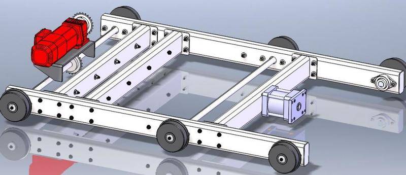

Let me try this again.
The train was just an analogy to describe an object readers would be familiar with.
Here is the situation:
I designed a very large weldment which rides on 6 steel wheels sitting on a steel track. (much like a train)
I have pneumatic cylinders attached to the weldment that will be pushing a fixed object and applying force against the weldment.
The steel wheels will lock by a brake on the motor used to move the weldment up and down the track.
The engineer i am working under has completed several coefficient calculations using steel on steel and decided the weight of the weldment alone, will be enough to allow the brake to keep the weldment from being pushed my the cylinders.
However, my mind tells me that the contact patch of the steel wheel on a steel track is so small that will be very little traction for the wheels.
Here is where "flat wheels" come into the story. the calculations did not take into effect the surface area of the wheel. Therefore, since a flat wheel has a larger surface area it does not make a difference, the friction would stay the same, so the amount of force required to move the weldment would not change from a flat wheel to a round wheel.
My opinion is the bigger the flat the bigger the contact patch will be. ultimately leading to more friction and less chance for the weldment to move.
Is my opinion correct or am i way off?:confused:

Think I got this time!

hey Student , now that you have uploaded a schematic it is much easier to see.
By the way just an idea that I would like to throw.
i guess the machine is being moved on a rail since the wheels.
Now making wheels with flat surfaces maybe is not a bright idea but how about attaching a electromechanical brake to the mainframe? Well for example next to the wheel pair attach a coil , similar ones come in old cassette players and other stuff where an applied dc current pushes out a rod of some sort with some given force that depends on the voltage/amperage applied coil windings diameter etc.Now in the end you can attach a simple brake pad.By the way many trains aleast in the earlier days used brake pads to brake down the main wheels , eliptic brake pads.That were pushed with compressed air to add to the braking power.
So what do you think how about a similar device whenever the frame stops the brake pad pushes out against the rail and considering you don't have tons of weight in this device I would say it wouldn't move anywhere , unless specially pushed ofcourse which is not the case I suppose.

Student, that is a beautiful drawing. I still think that my previous suggestion of a clamp is the most practical one, but I'll think on it some more.
You won't hear from me for a few minutes; I have to get myself out to my doorway because there's a beer delivery coming and it takes me 5 minutes to get there.
By the bye, that thing seems to have an awful hell of a lot of bolts for something that you claim is welded... :rolleyes:
edit: I just realized upon rechecking something that I suggested tapping your hydraulics for the clamp mechanism, whereas you stated that you are using pneumatics. My bad.

But student, that looks more like a "boltment"... it is a good picture, however. Can you tell us a bit more about it?
OCR... :smile:
IMHO, that looks like a simple mechanism, something to be said for simplicity. If you go adding mechanisms for braking you just create more fail points.
Since we know nothing of the load, the accelerations, or speeds involved it is impossible to make a meaningful assessment. If he wants control, then just using the wheels and motor it would be possible to achieve a rate of acceleration which just maintains the static friction between track and wheels and will bring the cart to a stop sooner then if the wheels were locked and a slide was induced.
Seems to me that a slide is very undesirable, you could damage wheels and track, in addition to a lower level of control of the final stopping point.
Integral, remember that Student specified earlier that the wheels are locked anyhow. I took this to mean that he wants a "parking brake" rather than a deceleration device. It has to overcome the resistance of whatever his pneumatic cylinders are pushing against, not just stop the thing.
The reason that I suggest anchoring it to the tracks is that it then has the full weight and structural support of the rail system.

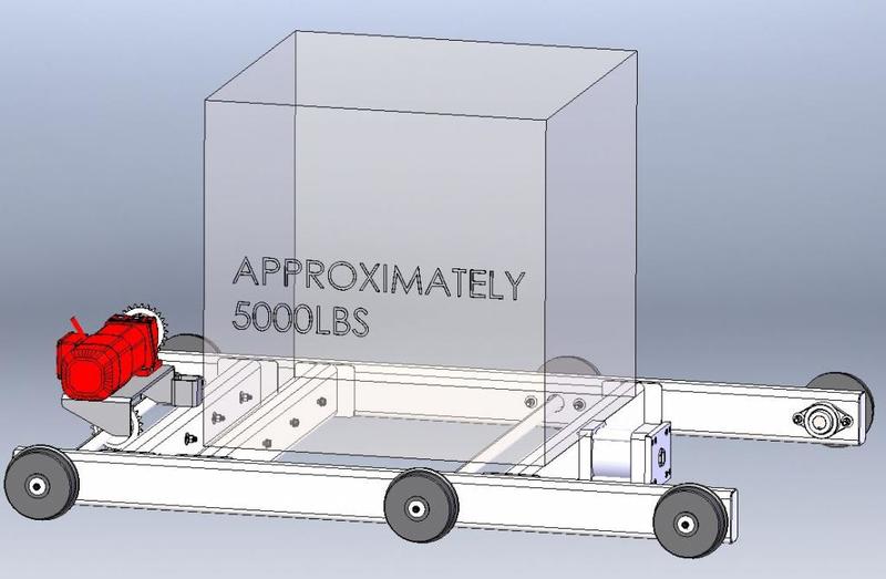

That was a prototype in the first picture. The entire machine will be a weldment after all the bugs are worked out. :smile:
Here is another image.
I added a mock weight for reference and the cylinder will produce approximately 20,000lbs of force against a stationary object.

Something doesn't add up here with the figures you give, for your light rail system.
5000 pound weight of the 'weldment' , and a 20,000 pushing force for the 'pneumatics'??
You stated earlier:
"The engineer i am working under has completed several coefficient calculations using steel on steel and decided the weight of the weldment alone, will be enough to allow the brake to keep the weldment from being pushed my the cylinders"
With an assumption of an approxiamate coeficient of friction for dirty or somewhat greasy ( ie not clean ) steel on steel of 0.1, your static friction force to hold the car in place in only 500 pounds, with no safety facture.
Or your car needs to weigh more than 200,000 pounds.
Something is not so genius as you say, or your forces are incorrect.
20,000 pounds supplied by pneumatics.
What bore and pressure are you using?
  • #34
There is more then 1 pneumatic cylinder.
I removed the top of the assembly including all other cylinders from this image.
The total force produced from the cylinders is going to be about 20,000lbs.
The tracks and wheels will be covered to eliminate any chance of oil.
The answer i am searching for is to the question of friction.. I think?
When finding the coefficient of steel ( he used.8) this calculation does not take into account the surface area. I am baffled by this because the logically the bigger surface area the more traction.
I am not an engineer, but a car can stop faster with wider tires. Same rubber and same road and same weight, just different surface area..
You stated earlier:

Yes, I agree the weight of the machine will not hold in place with only gravity.
However, the coefficient equation implies that it will.

Challenge accepted , put an extra set of wheel pairs to the device and then repeat the last think mentioned by Danger... :d
Here is your worse.
And speaking about the friction part and holding , even without calculations just from common sense I can assure you that Danger is right the device having a weight of that mentioned above and a horizontal push with a force of 4 times the vertical weight probably won't hold it.
I suggest you need some clamp or brake added to the device to make it absolute.
