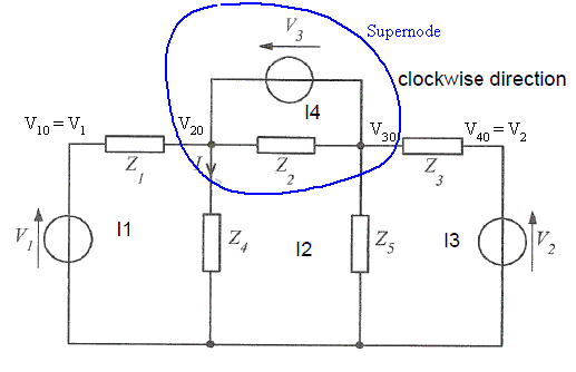

gneill said:
Leave ##V_3## as ##V_3## for now! That way you don't have to carry around any complex digits through the initial simplifications. Don't be in a hurry to plug in numbers, especially complex numbers; That just gives more opportunities to make transcription and sign errors, and makes it more difficult to spot mistakes in the workings.
You should then have:
##\frac{V_1 - V_{20}}{Z_1} + \frac{-V_{20}}{Z_4} + \frac{-(V_{20} - V_3)}{Z_5} + \frac{V_2 - (V_{20} - V_3)}{Z_3} = 0##
which becomes, after distributing the signs:
##\frac{V_1 - V_{20}}{Z_1} - \frac{V_{20}}{Z_4} + \frac{V_3 - V_{20}}{Z_5} + \frac{V_2 - V_{20} + V_3}{Z_3} = 0##
Can you carry on from there to isolate ##V_{20}##? You should be able to reach a point where you have something like:
##V_{20}[## some terms ##] + [## more terms ##] = 0##
Then you can work on reducing the "some terms" and "more terms" down to individual complex numbers, since then all the variables in them will be known values.

I don't recall any V4 being defined. There was a V40, which was at the junction of Z3 and V2. As such, V40 is dropped in favor of using V2 which has a given value. There was also a voltage V30 defined to be the potential of the node at the top of Z5. But thanks to the supernode, it is replaced with V20 - V3.

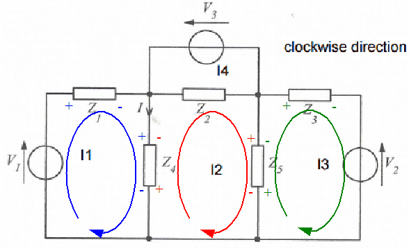

Hi I am stuck on part a of this question:
the 3 mesh equations i have are:
Mesh1:
2I1-j5I1+j5I2=120
Mesh2:
j5I1-j1I2-j4I3=-14.14+14.14
Mesh:3
-j4I2+4I3+j4I3=-120
I have tried to use the matrix spread sheet to find I1,I2 & I3. But my answers seem well out.
9.11E+00+j1.23E+01
4.18E+00-j8.04E+00
-8.89E+00-j1.69E+01
Any help would be much appreciated.

Verify the signs and magnitudes for the circled entries.

im struggling abit with the nodal analysis. i think i have simplified the equation appropriately.
Equation with substitution for v30: ( v10 - v20/ z1)) + ( v20/ z4) + ( v20 - v3 / z5) + (v2 - v20 + v3/ z3) = 0
i have split the fractions to start isolating v20(v1 / z1) - (v20 / z1) + (v20/z4) + (v20/z5) - (v3/z5) - (v3/z5) + (v2/z3) - (v20/z3) + (v3/z3) = 0
So
v20( -(1/z1) + (1/z4) + (1/z5) - (1/z3) ) + (v1/z1) - (v3/z5) + (v2/z3) + (v3/z3) = 0
v20( -(1/2) + (1/-5j ) + (1/4j ) - (1/4) ) + (120/2) - (14.14 + 14.14j /4j) + (120j /4) + (14.14 + 14.14j /4) = 0
v20( - 0.5 + 0.2j + 0.25j - 0.25) + ( 60 - ( 3.535 - 3.535j) + (30j) + (3.535 + 3.535i) = 0
v20( - 0.5 + 0.2j + 0.25j - 0.25) + ( 60 - 3.535 + 3.535j + 30j + 3.535 + 3.535i = 0
am i going the right way about this? The double negatives in the mesh analysis started to boil my head so thought finding the nodal analysis would be more simple, and then i could compare the two answers for the current through z4.
It looks to me like you're mixing current directions. You want to either sum all currents flowing into the node, or all currents flowing out of the node, and set the result to zero. Don't mix directions.
For example, your first term: ( v10 - v20/ z1)) {which I assume to mean ( (v10 - v20)/ z1)): watch your parentheses to group operations appropriately!} represents a current flowing into the supernode at V20 through impedance Z1. But your second term, ( v20/ z4), represents a current flowing OUT of the supernode via Z4.
Check each of your terms and assure that they all represent currents flowing in the same manner, either into or out of the supernode, and not both.

All finished nodal analysis and answer is correct. Had another attempt at the mesh analysis, unfortunately the matrix spreadsheet will not calculate I1,2,3. I am lost here, i have repeated the same 3 equations.
KVL walk clockwise around the 3 loops
Mesh 1 -
v1 - (z1)i1 - (z4)(i1 - i2) = 0
v1 = (z1)i1 + (z4)(i1 - i2)
v1 = (2)i1 + (-5j)i1 + (5j)i2
120 = (2 - 5j)i1 + (5j)i2 ....(1)
mesh 2 -
-v3 + (z5)(i2 - i3) + z4(i2 - i1) = 0
v3 = (4j)i2 - (4j)i3 (-5j)i2 + (5j)i1
v3 = (5j)i1 + (4j - 5j)i2 (-4j)i3
14.14 + 14.14j = (5j)i1 + (-1j)i2 + (-4j)i3 ...(2)
Mesh 3 -
-v2 + z5(i3 - i2) + z3(i3)
v2 = + (-4j)i2 + (4 + 4j)i3
120j = (-4j)i2 + (4 + 4j)i3
...(3)
Check the sign of v3 in your mesh 2 equation. You appear to be writing a sum of potential drops, so...
I'm not so sure. What is wrong with v3 in my mesh 2 equation.
Assuming clockwise current of circuit. It would be a negative voltage with positive voltage drops across the impedances?

np. I just did not know... if that is the case then one of the Z terms in your mesh equations has the wrong sign...

wow... your equation for mesh two is not correct.
are you probing for someone to do just your work for you?
you have been told multiple times that there is a problem with your equation for mesh 2. Its hard to be more clear.
No, really. I am genuinely not looking for that. I am just struggling with this question.
If you do a KVL "walk" around the second loop in a clockwise fashion, does v3 cause a potential rise or a potential drop?
