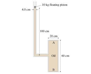

An oil filled system is shown in the figure below. The density of the oil is
In the figure(Figure 1)how much force does the fluid exert on the end of the cylinder at A?
[/B]
Solved for Poil using P = Po + F/A = 1.79 X 105. Simple enough.
Since pressure is the same across any level, we first have to first figure out the distance from Po to the top of A. This is where I am stuck. I feel like its something very simple but I just don't see it!
The distance is 70cm. We did this one in class, but I still don't see it.
You have to make an assumption based on the appearance.
This goes against everything I was ever taught, but as soon as you posted this it made sense. Thank you!
