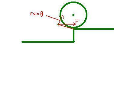

what minimum horizontal force is needed to pull a wheel of radius R and mass M over a step of height H. force is supplied at center of wheel.
Draw yourself a force diagram. Just to get you started right, make the step height smaller than R, otherwise no force will be sufficient. The verticle component of the force exerted by the step upon the wheel must counteract gravity, so that it lifts off of the ground.
You might also want to show that the process "runs away". As the wheel climbs over the step, less force is needed. This ensures that you don't have to worry about climbing partly up the step and rolling back down.
Njorl
Given force is horizontal
We should look for conservation of Energy
torque = F * R, but where do i factor in the H?
nope torque is not FR here
is torque even used in this problem?
[tex]Fsin \theta R=I \alpha[/tex]

im stuck at F*sintheta = m * a now.
how do i factor in the H?
[tex]Fsin\theta r = i \frac{d\omega}{dt}[/tex]
[tex]FRsin\theta d\theta=\omega I d\omega[/tex]
solving this from fig uget
[tex]\frac{I\omega^2}{2}=\frac{FRH}{\sqrt{R^2+(R-H)^2}}[/tex]
Apply Conservation of Energy
[tex]F=\frac{mg \sqrt{R^2+(R-H)^2}}{R}[/tex]
Do the torque calculations about the edge of the step. Torque due to the normal force is zero. That leaves torque due to gravity, and torque due to the applied force which must be larger.
I get
[tex]\tau_F=-(r-h)F[/tex]
(negative because it is clockwise)
[tex]\tau_G=mg\sqrt{R^2-(R-H)^2}[/tex]
and
[tex]\tau_F>-\tau_G[/tex]
so
[tex]F > \frac{mg \sqrt{2RH-H^2}}{R-H}}[/tex]
Sorry i lost NateTG is correct
